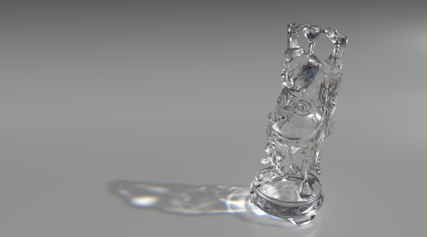

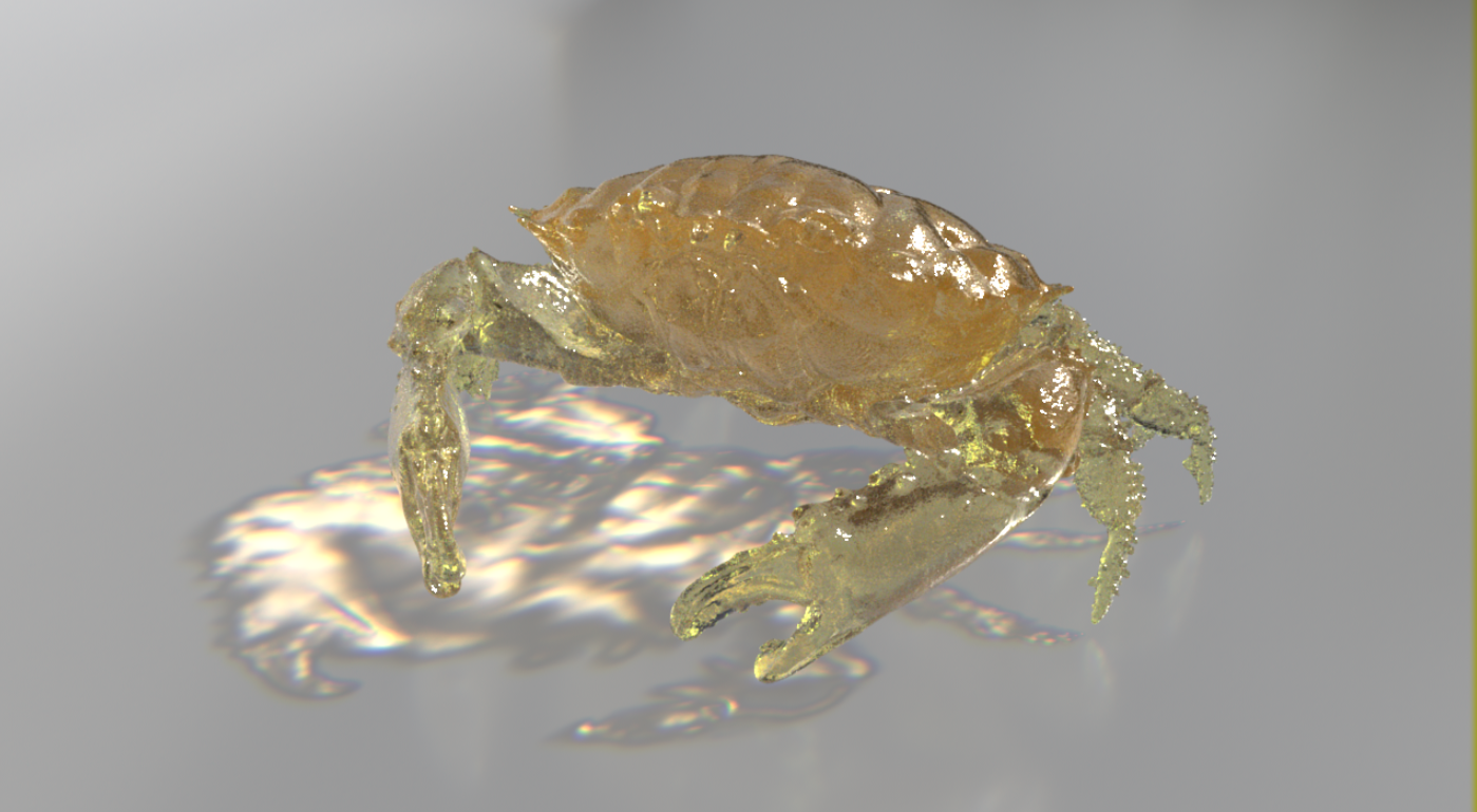

Fake Caustic Effect - Arnold for Houdini

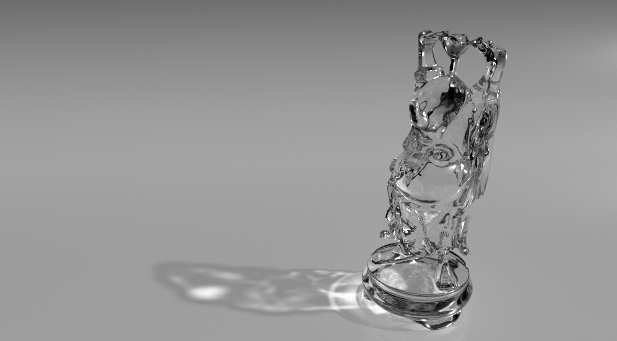

Glass transmission fake caustic on floor plane (Shadow Matte)

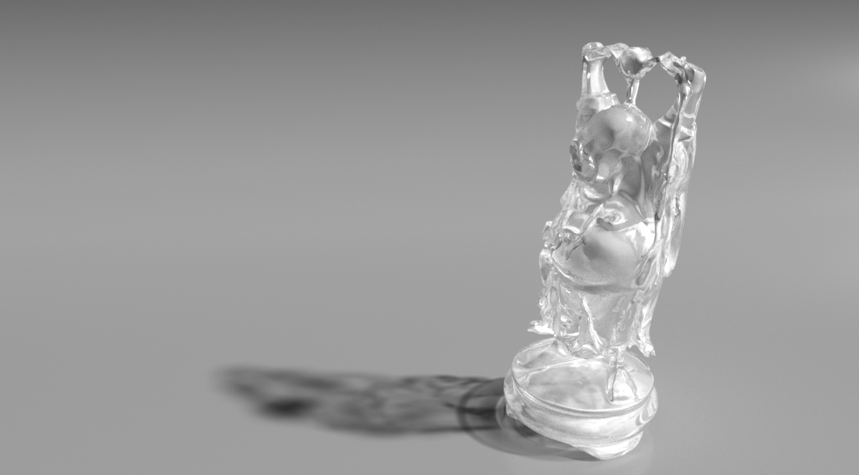

Arnold is a unidirectional path tracer, and therefore, realistic caustics can be expensive to render. This is because caustic effects create a lot of noise and require very high sampling values, which can lead to long rendering times. This tutorial shows how to create a fake caustic effect that is far cheaper to render but still looks convincing. It uses a combination of the Ray Switch, Standard Surface, and Facing Ratio shaders and assigns them to the object that emits caustics. A Shadow Matte shader is then assigned to the floors' Standard Surface Emission attribute that gives the caustic effect.
It should be noted that the technique in this tutorial is not physically correct and does not demonstrate the result of a physically correct caustic effect. However, in most cases, the rendered results should be sufficient to fool the eye. Thanks to Slava Sych for his help with this tutorial.

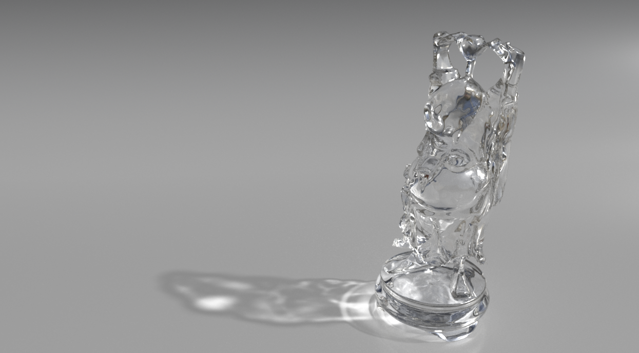

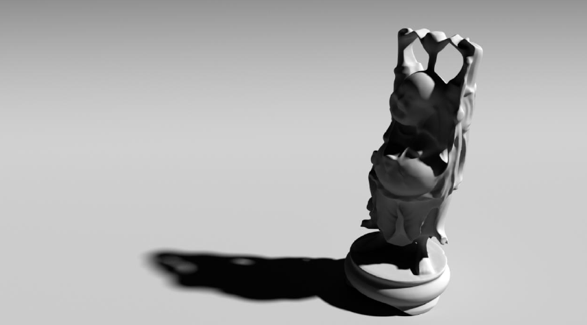

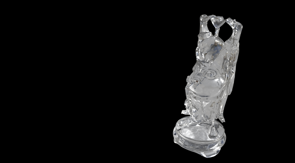

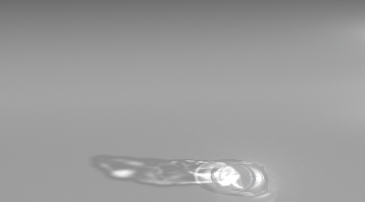

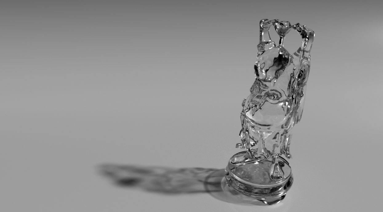

Render Layers for Compositing
Now the scene is ready to set up render layers for AOV compositing. These can be used to fine-tune the caustics, add dispersion effects, etc.
Caustic layer Glass layer Precomp version
