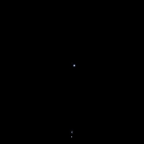

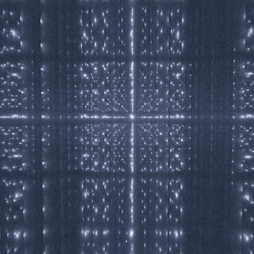

Specular Ray Depth keyframed over time (1-50)

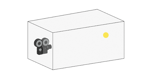

  • Start off by creating a cube and scaling it out in one direction.
  • Select the end face of the cube and taper it out slightly. This will help to create more internal reflections.
  • Create a Point Light and position it towards the back face (tapered end) of the tapered cube.
  • Create a camera and position it at the other end of the cube (inside it), pointing at the point light.
    Camera pointing at a Point Light inside a tapered reflective cube

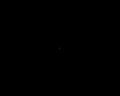

  • Render the scene. You should see something like the render below using the default Arnold render settings.
Render using the default Specular Ray Depth: 1

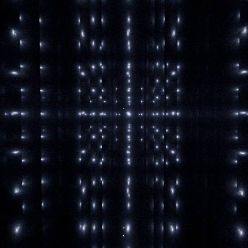

  • Try increasing the Specular Ray Depth to see more internal reflections of the point light.
Important:
> Increasing the Specular Ray Depth value will dramatically increase render times.
1 (default) 10 20
Note:
You may need to increase the number of Specular Samples to resolve some of the Specular Roughness noise for the final rendering.
