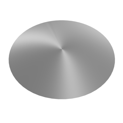

| Anisotropic brushed metal effect visible in the base of the pot |
This short tutorial will show you how to create a realistic steel shader with anisotropic reflections to create a brushed metal effect on the base of a pot. Anisotropic reflections are based on the orientation of small grooves (bumps, fibers, or scratches) that exist on a reflective surface. We will achieve this effect using a combination of a radial ramp connected to the anisotropy and a noise texture connected to the bump map attribute.

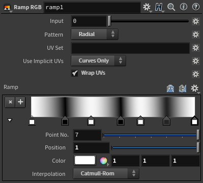

Ramp RGB
- Connect a Ramp RGB to the Specular Anisotropy parameter.
- Change the Ramp RGB Type to Radial. Insert four black and four white colors into the ramp. Change their Interpolation to Smooth.

The Anisotropic brushed metal effect should now be visible at the base of the pot. However, it is lacking the bumped ridges associated with this effect.

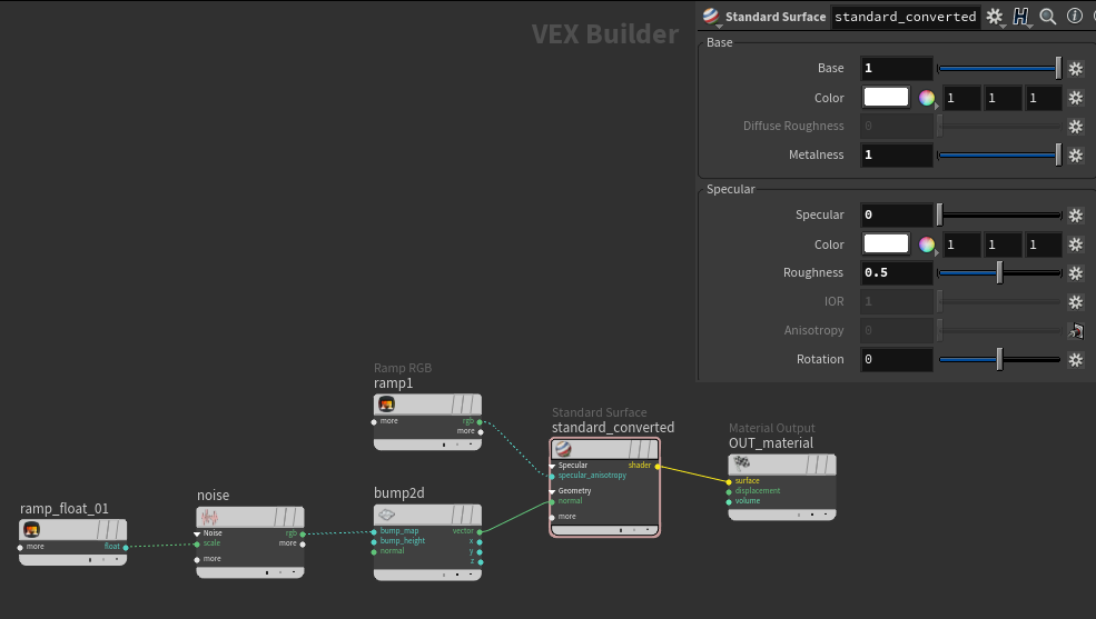

Now we need to create a scratch effect and connect it to the bump attribute to achieve a subtle brushed metal effect. We can do this using the following shaders:
Ramp Float -> Noise -> Bump2d
- Create a Bump2d and connect it to the Normal Camera of the pots base shader. Set the Bump Height to around 0.5.
- Create a Noise shader and connect it to the Bump Map of the Bump 2d. Change Octaves to 8 and Amplitude to around 0.4.
- Create a Ramp Float)* and connect it to the **Scale of the Noise shader. Change the type to Circular. This will give us the concentric ring effect that we want.

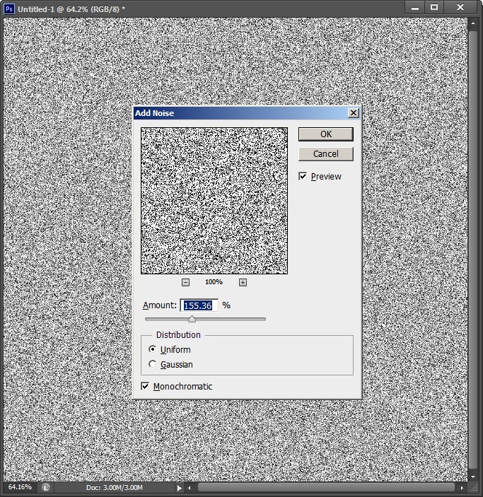

You can create a scratch map in Photoshop and connect it to the bump attribute to achieve a subtle brushed metal effect.
- Go to Filter-> Noise-> Add Noise to add some noise to the image.

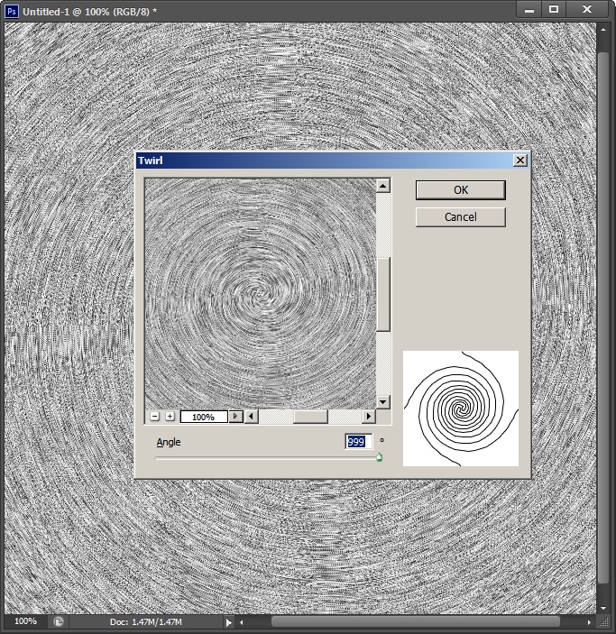

- Go to Filter-> Distort-> Twirl to add a circular effect to the noise. You may need to do this two or three times to get the desired effect. Crop the image and save it.

Final shading network
