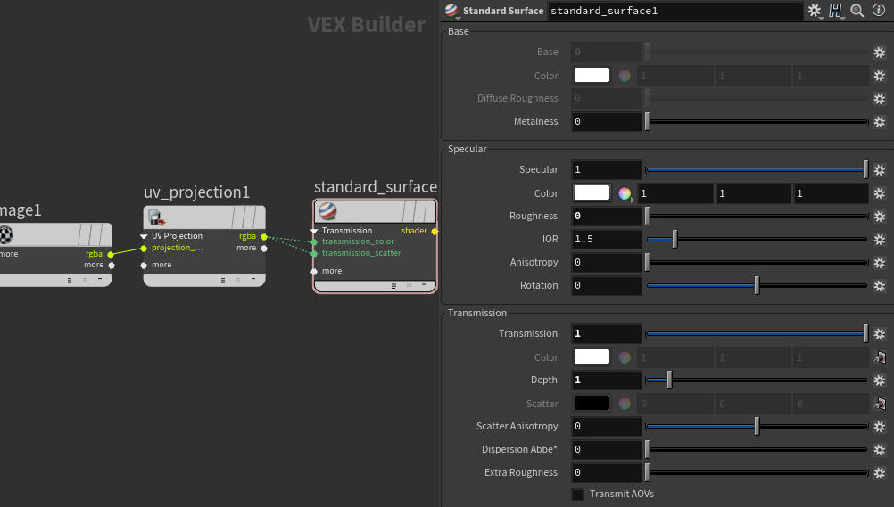

Transmission
Now we need to connect our marble texture to the Transmission Color and Transmission Scatter. Transmission Scatter is suitable for any material that is fairly thick or where there is enough of it for scattering to be visible, such as honey. Transmission Scatter with Depth is key to the look for our marble shading.
- Create an Image shader and open the marble texture that you want to use.
- Connect the Image to a UV Projection shader. We want to map the texture spherically around the sphere so change the Projection Type to Spherical.
- Connect the UV Projection to the Transmission Color and Transmission Scatter of the glass Standard Surface shader.

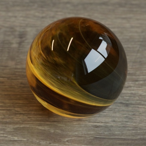

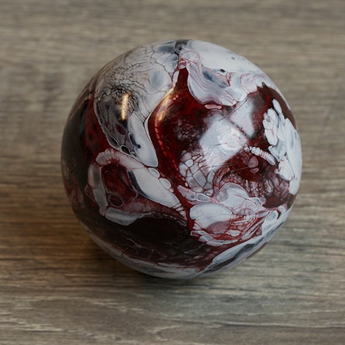

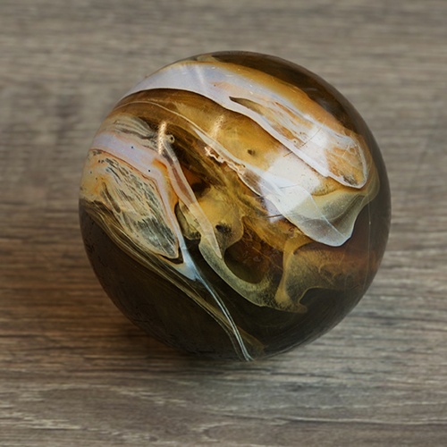

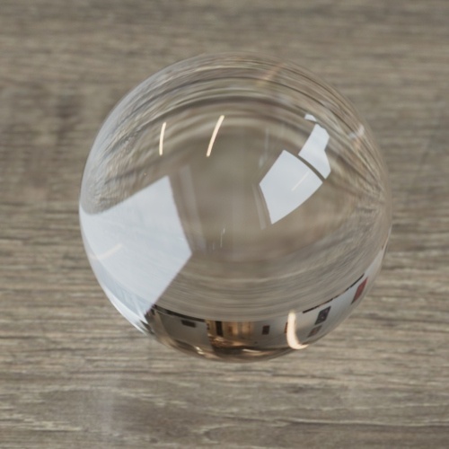

- Increase the Transmission Depth to 1. You may want to experiment with this value depending on the texture that you are using and the look that you want to go for. Changing this value will have a large effect on the overall marble shading, as you can see in the images below.

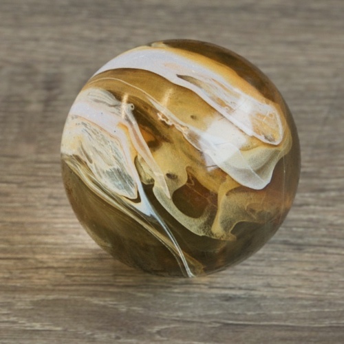

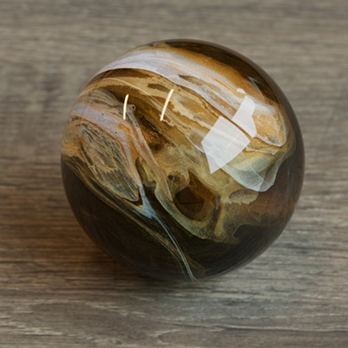

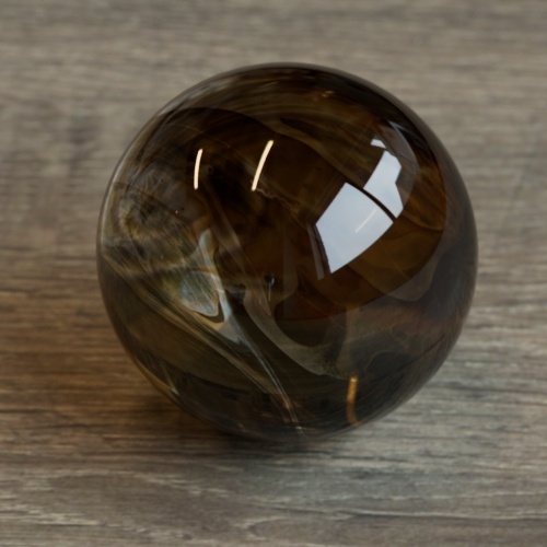

| Transmission Depth: 0 (default) | Transmission Depth: 1 | Transmission Depth: 3 |

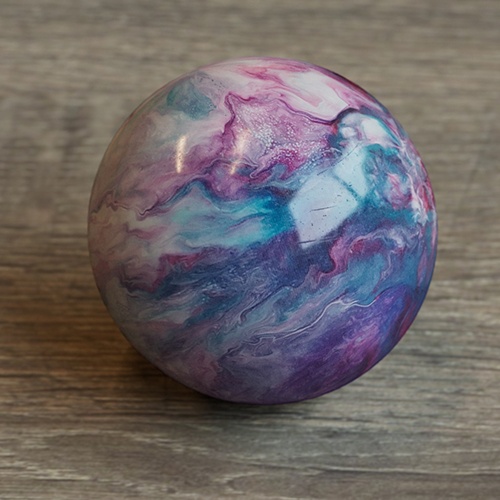

- Adjusting the U/V Angle (for spherical mapping only ) of the UV Projection can give an interesting 'stretched' marble type pattern. You can also use the Matrix attributes of the UV Projection to further refine the effect.

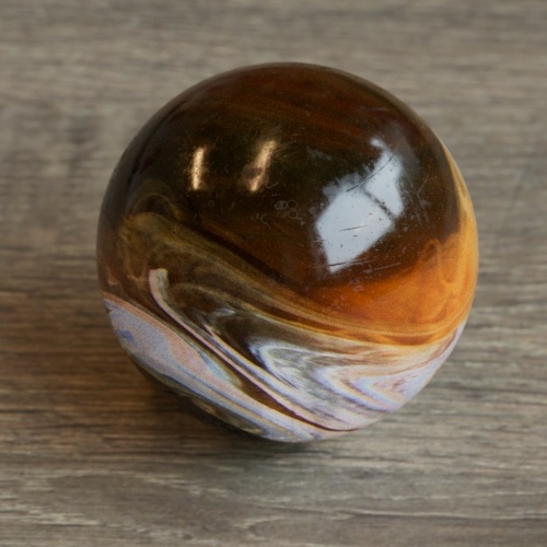

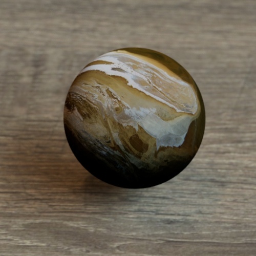

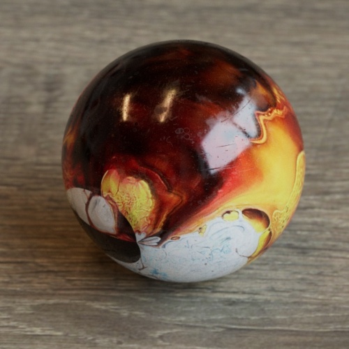

| U Angle: 30. V Angle: 230. Scale X: 0.3 | U Angle: 330. V Angle: 90. | U Angle: 270. V Angle: 30 |

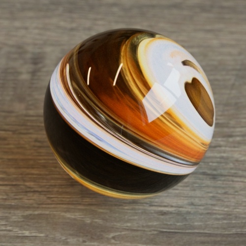

- Now unhide the glass sphere and render the scene.
Make sure that the Skydome Light has enough Volume Samples otherwise the volume will appear noisy.
Marble glass shading with volume inside
