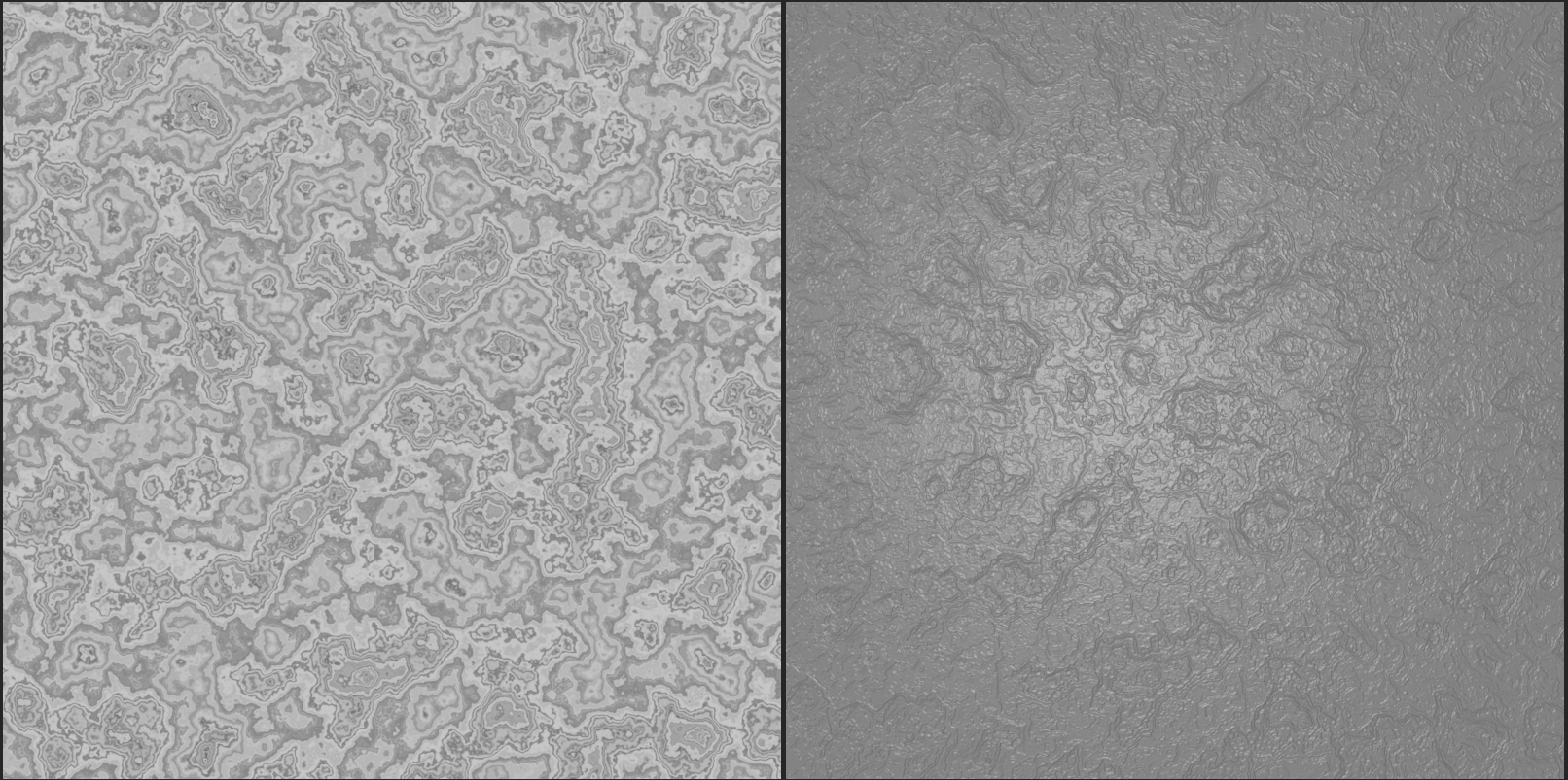

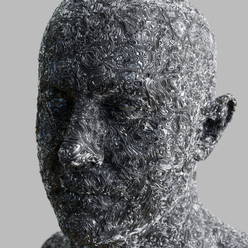

Noise shaders can be a powerful tool when used creatively. It is possible to create various effective patterns, for example, different types of corrosion, foam, landscapes, alien skin, or just organic patterns. This tutorial demonstrates the types of patterns possible when setting different attributes with the Arnold Noise and Cell Noise shaders. Hopefully, this tutorial will inspire you to experiment and create your own patterns using a combination of Noise shaders. Thanks to Slava Sych for his assistance with this tutorial.

Noise patterns -> displacement
Noise patterns -> Volume Displacement

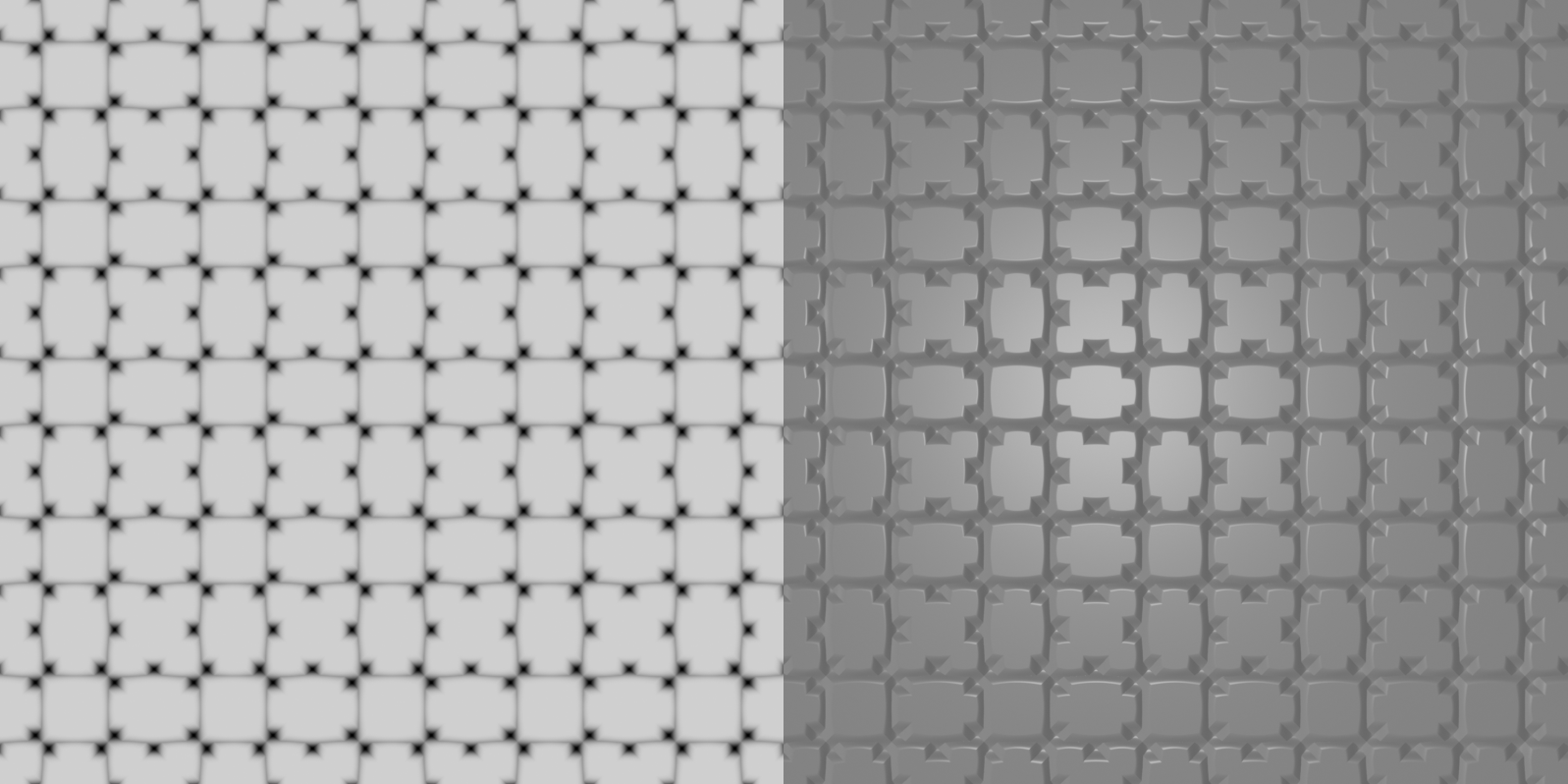

Noise Shaders

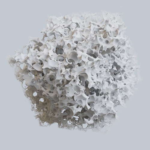

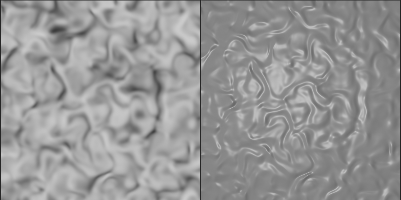

Noise Type 1
Octaves: 1. Distortion: 1.2. Lacunarity: 1. Scale XYZ: 10
Noise Type 2
Octaves: 1. Distortion: 5.2. Lacunarity: 1. Scale XYZ: 10.

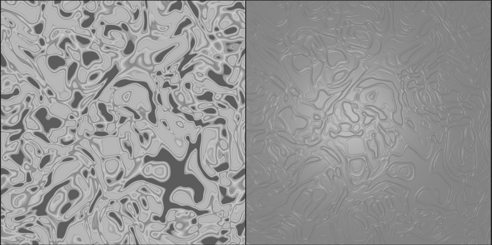

Noise Type 3 (Noise x2)
Create a Noise shader and set the following parameters:
  • Octaves to 1.
  • Distortion to 5.
  • Lacunarity to 3.25.
  • Scale XYZ to 0.
Next, create another Noise shader and connect its output to the Offset parameter of the first Noise shader. Set the following:
  • Octaves to 5
  • Distortion to 4
  • Lacunarity to 1
  • Scale XYZ to 5

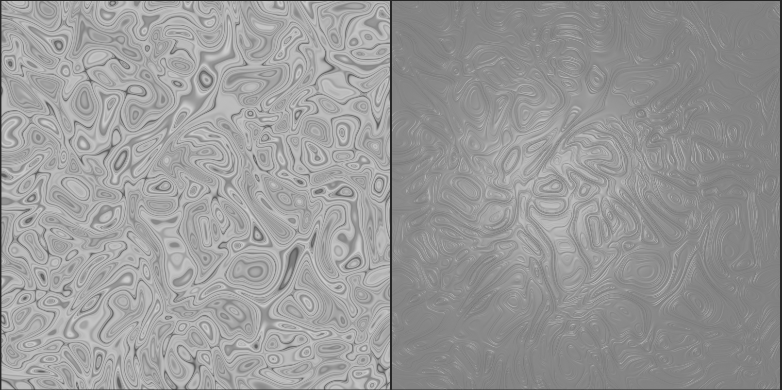

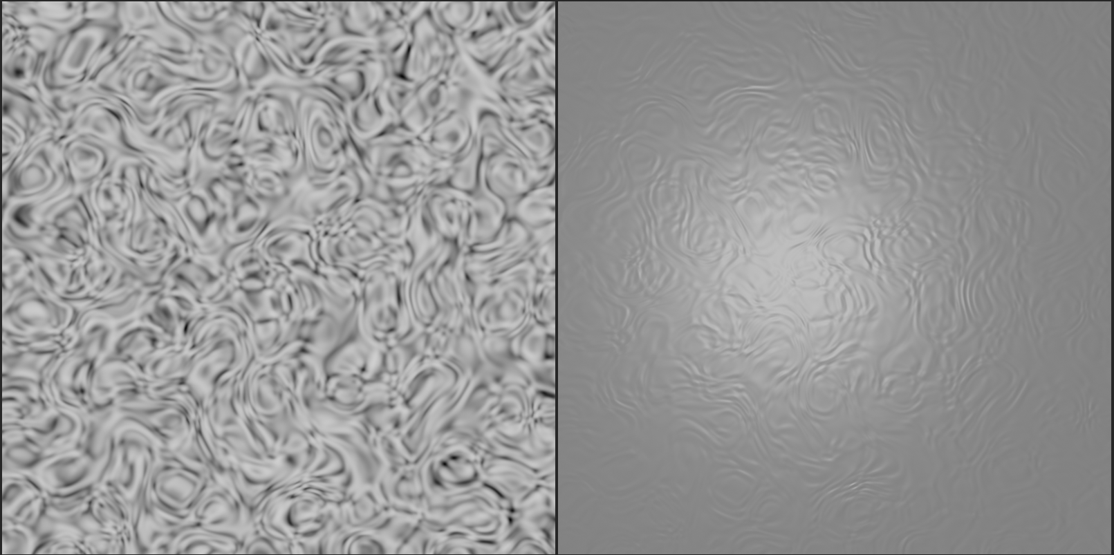

Noise Type 4 (Noise x2)
  • Octaves to 1
  • Distortion to 5
  • Scale XYZ 10
Next, create another Noise shader and connect its Output to P parameter of the first Noise shader. Set the following:
  • Octaves to 2
  • Distortion to 3
  • Lacunarity to 1
  • Amplitude 0.21
  • Scale XYZ to 5

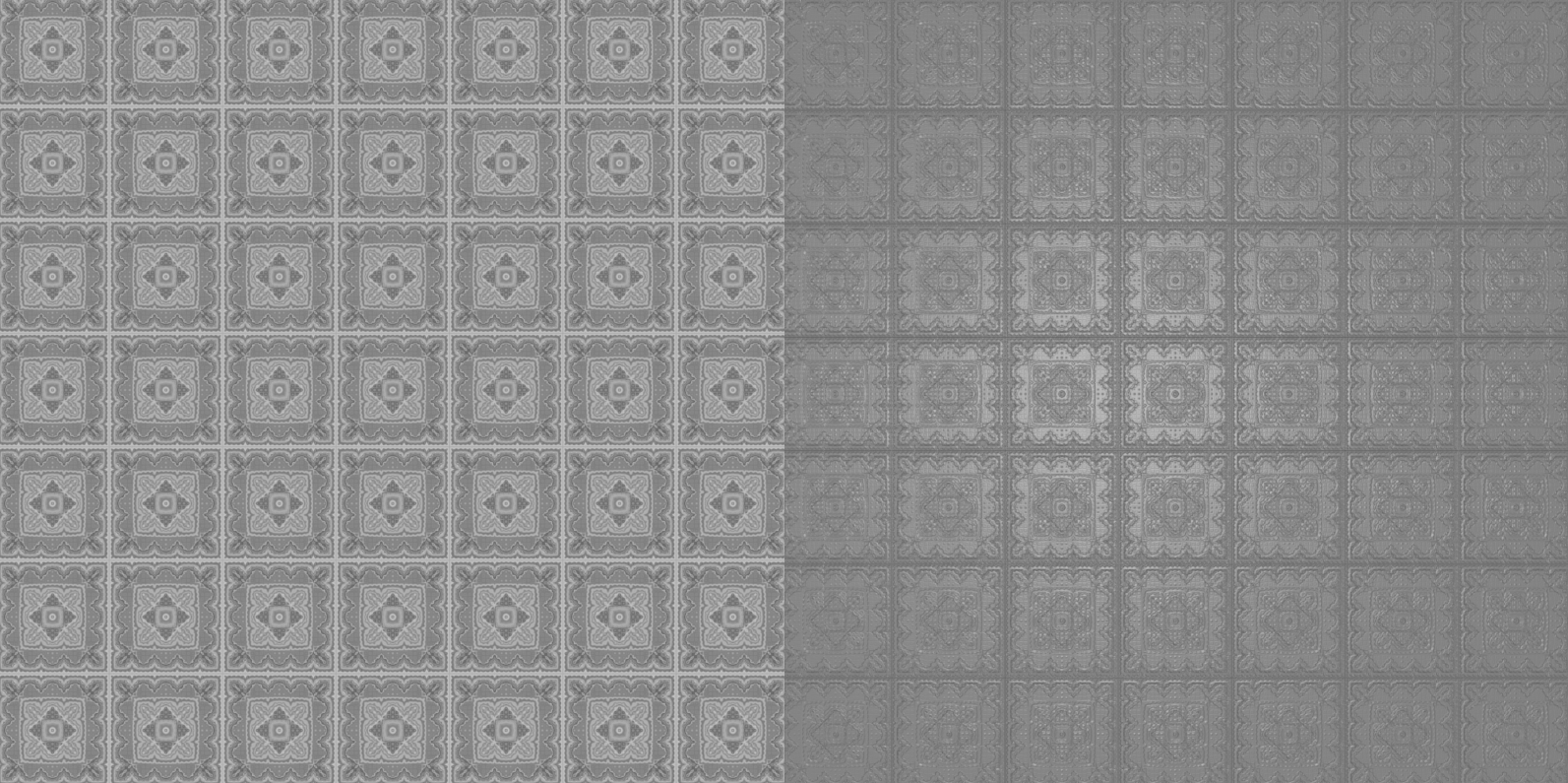

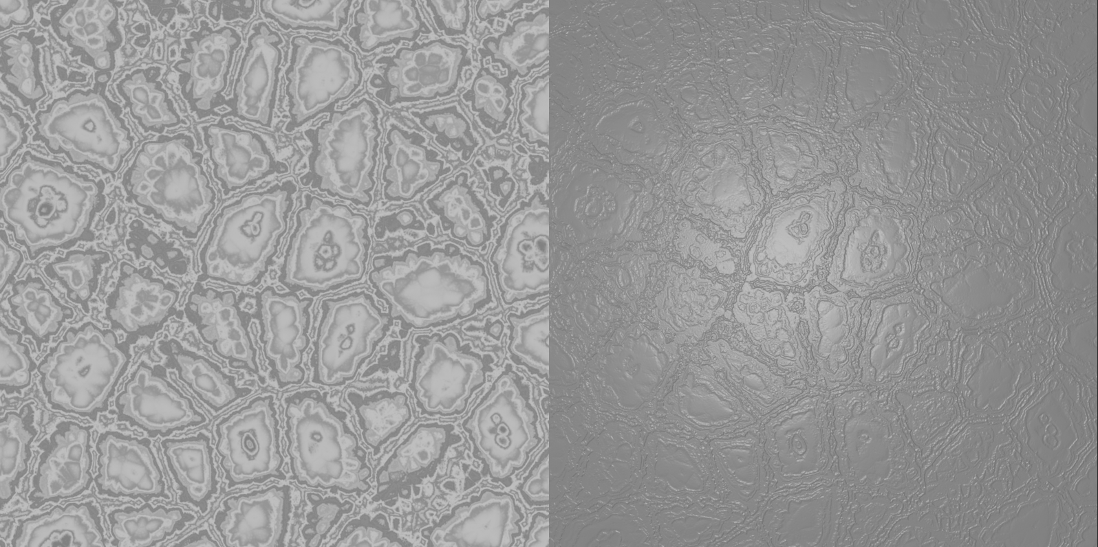

Noise Type 8 (Cell Noise ->Noise)
  • Octaves to 1
  • Distortion to 3.1
  • Lacunarity to 1
  • Scale XYZ 6
Next, create a Cell Noise shader and connect its Output to P parameter of the first Noise shader. Set the following:
  • Change Pattern to worley2
  • Enable Additive
  • Octaves to 4
  • Lacunarity to 5
  • Amplitude to 0.114
  • Scale XYZ to 7
  • Density to 0.623
  • Randomness to 1

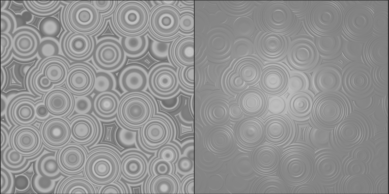

Noise Type 9 (Cell Noise ->Noise)
  • Octaves to 1
  • Distortion to 3.1
  • Lacunarity to 1
  • Scale XYZ 6
  • Change Pattern to Alligator
  • Enable Additive
  • Octaves to 1
  • Lacunarity to 5
  • Amplitude to 0.920
  • Scale XYZ to 7
  • Density to 0.623
  • Randomness to 0

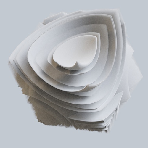

Noise Type 10 (Cell Noise -> Noise)
  • Octaves to 1
  • Distortion to 3.533
  • Lacunarity to 1
  • Scale XYZ 6
  • Enable Additive
  • Octaves to 3
  • Lacunarity to 5
  • Scale XYZ to 7
  • Density to 0.549
  • Randomness to 0

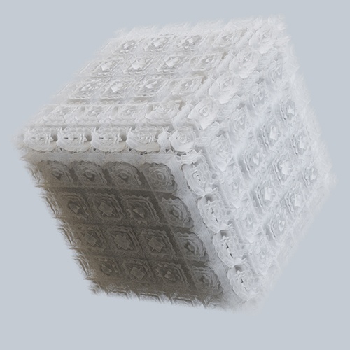

Noise Type 11 (Cell Noise ->Noise)
  • Octaves to 1
  • Distortion to 10
  • Lacunarity to 1
  • Scale XYZ 6
  • Turn on Additive
  • Set Octaves to 3
  • Lacunarity to 5
  • Amplitude to 0.177
  • Scale XYZ to 7
  • Density to 0.549
  • Randomness to 1

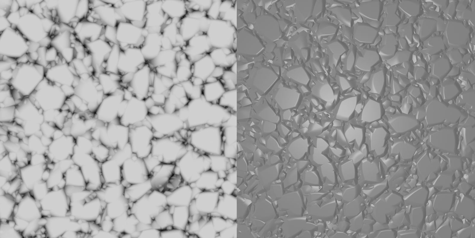

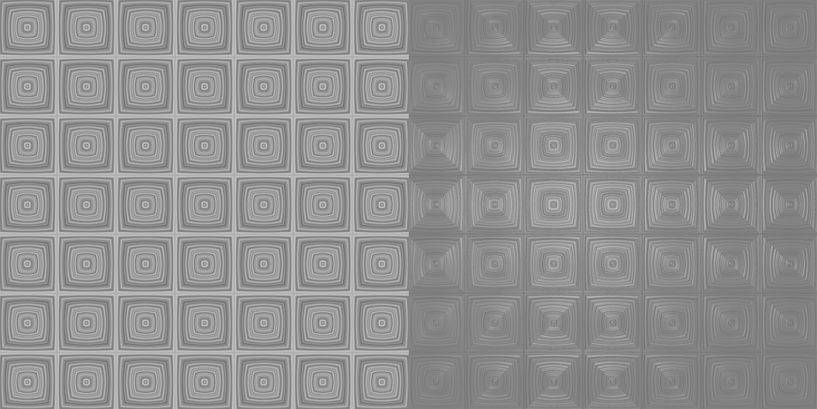

Cell Noise Type 2 (Cell Noise -> Range)
Create a Cell Noise shader and set the following parameters:
  • Disable Additive
  • Octaves to 2
  • Lacunarity to 1.5
  • Amplitude to 1
  • Scale XYZ to 10
  • Density to 0.326
  • Randomness to 0
Next, create a Range shader and connect the Cell Noise to its input parameter. Set the following:
  • Input Max to 0.343
  • Enable Smoothstep
Cell Noise Type 3 (Cell Noise -> Range)
  • Disable Additive
  • Octaves to 6
  • Lacunarity to 1.297
  • Amplitude to 1
  • Scale XYZ to 10
  • Density to 0.326
  • Randomness to 1
  • Enable Smoothstep
