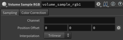

The volume_sample_rgb shader will sample a volume channel of the new volume API. It should be connected to one of the components of the volume_standard shader if you need to further edit the result of the reading of a channel, for instance, to color correct it, etc.

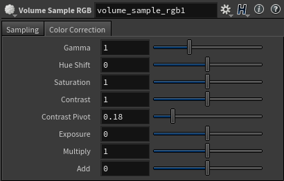

Color Correction
Similarly, volume_sample_rgb has a set of parameters to alter the output color, regrouped in the Color Correction tab. The operations are applied in the same order as the parameters.
