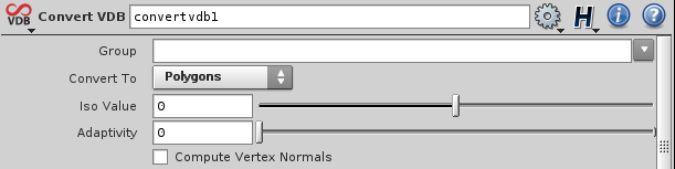

To render fluids using Arnold for Houdini, the resulting converted mesh needs to be Polygon rather than Polygon Soup. Support for polygon soup will be added in the future.

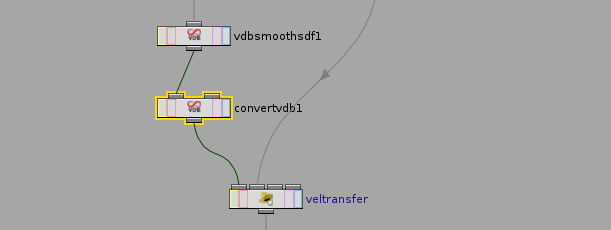

Enter the fluid node to view the internal network
Change Convert To to Polygons
