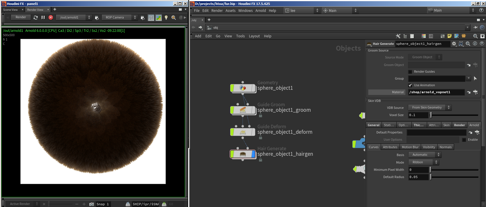

Arnold curve attributesadded to Hair Generate node. standard_hair in Arnold Vopnet -> Material.
Adding motion blur to fur requires deform_keys.
