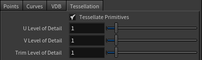

Tessellate Primitives
Enable tessellation of Houdini primitives before sending them to Arnold. On by default. It also works for platonic surfaces.

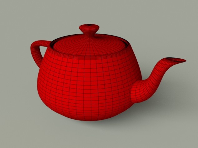

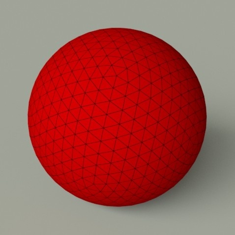

U/V Level of Detail
Specifies the number of U/V subdivisions of the surface being converted.
U/V Level of Detail: 1 U/V Level of Detail: 3 U/V Level of Detail: 5
Trim Level of Detail
Specifies the level of detail for trim curves of the surface being converted.
