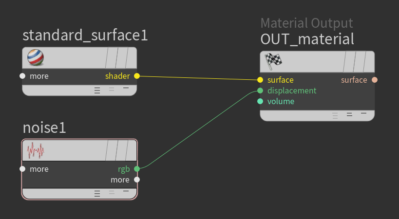

A material with a noise displacement

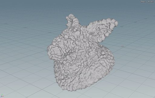

Pig geometry bake has been baked with the animated noise shader
