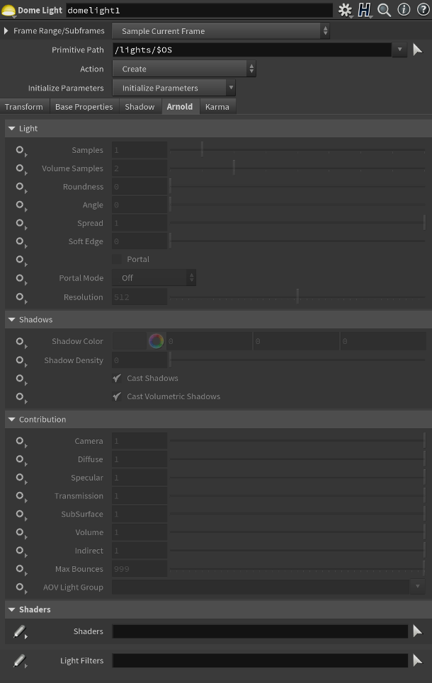

The Arnold Skydome Light parameters are available through the Dome Light node.

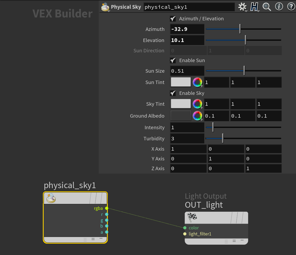

Attaching a Physical Sky shader
To attach a Physical Sky create a new material with a Light Output node.

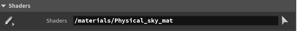

  • Connect the Physical Sky material to the shaders paramater of the Dome Light.

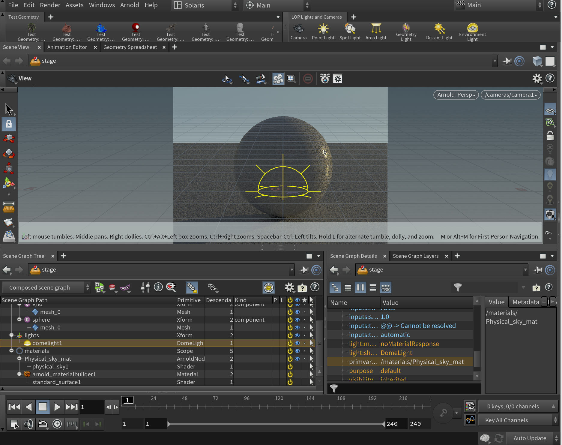

Here is an example of the network you should have at the end:
Here is an example of the rendered output:
