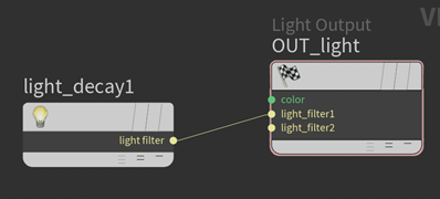

  1. In a Material Library LOP, create an Arnold Material Builder
  2. In the Arnold Material Builder, create a Light Output.
  3. Connect a light filter (such as light_decay or gobo) to a light_filter port on OUT_light. light_filter_OUT_light

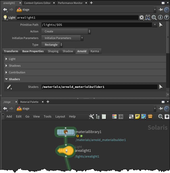

  4. In the light parameters, under Arnold > Shaders, select the ArnoldNodeGraph (the Arnold Material Builder node). light_shaders
