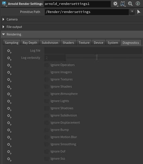

An Arnold-specific tab containing similar parameters to the Arnold ROP is available here in Solaris, created under the Rendering -> Render Settings menu item. The Arnold tab is automatically created with the RenderSettings LOP, and contains the following Tabs to control the Arnold render settings:
By default, none of the parameters are set in the USD unless specified by Creating and Setting Attributes.

Diagnostics
This tab contains the parameters to control the Arnold diagnostic parameters. See the Diagnostics documentation on the Arnold ROP.
Log Verbosity
Verbosity for the Render Settings LOP. The verbosity levels are cumulative, so 2 includes Warnings and Errors.
