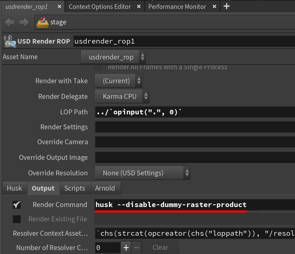

Colorspaces are wrong in Houdini 20 when rendered to disk
In Houdini 20 husk, creates a new dummy buffer RGBA, which can be disabled with: --disable-dummy-raster-product
