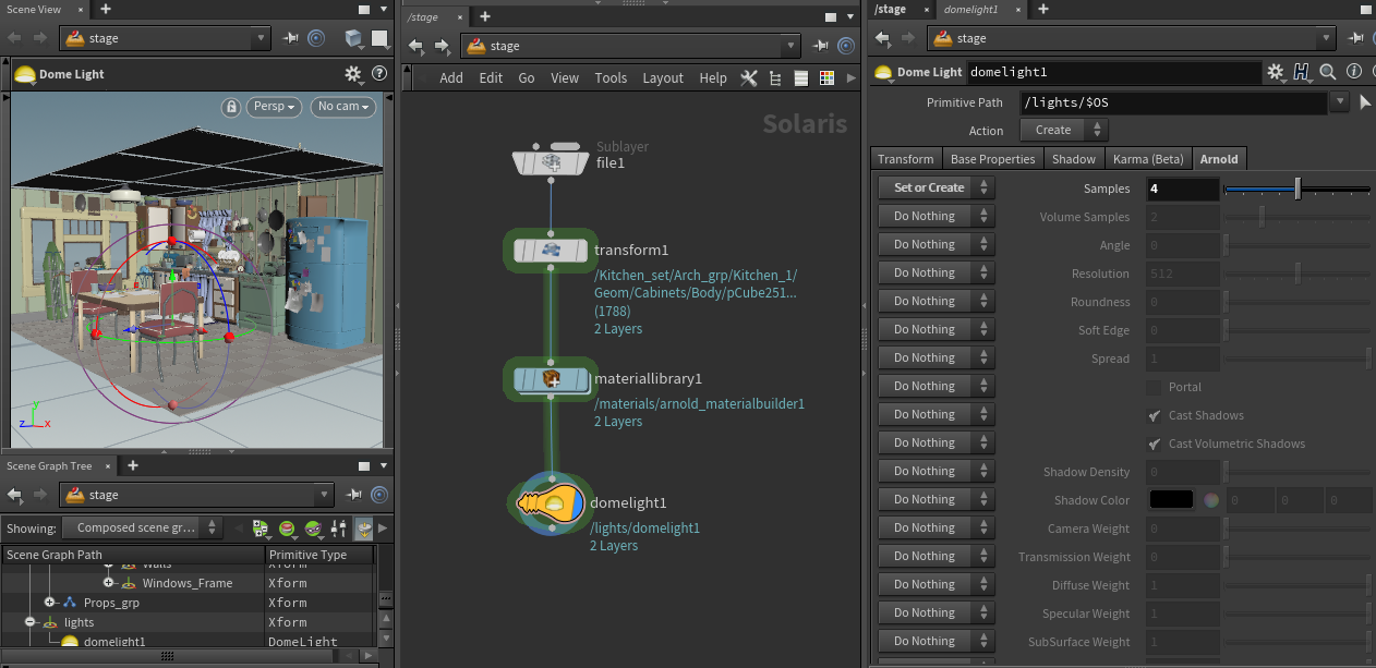

  • Create a Dome Light and connect it to the materiallibrary node.
  • Under the Arnold Tab of the Dome Light, change the Samples to 4 (choose Set or Create).

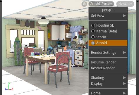

Viewport Rendering
  • Select the Persp dropdown menu in the camera viewport and choose Arnold from the Hydra delegate list. You should now see the kitchen USD rendered with Arnold.

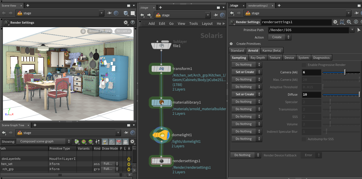

Now let's set up the scene for final frame rendering. To improve the noise, we need to adjust the lighting and render settings.
  • Create a Render Settings node and connect it to the Dome Light.
  • Change the desired resolution in the Standard tab of the Render Settings node.
  • Under the Arnold Sampling tab, set the Camera (AA) samples to 5 or 6 for final frame rendering.
  • Set the Diffuse samples to around 10 to improve the quality of the indirect lighting in the scene.
Note:
More information about sampling settings in Arnold can be found here. Tutorials on how to reduce noise can be found here.
  • Create a camera node and insert it before the Render Settings node.
  • Create a USD Render ROP and connect it to the Render Settings node.
  • You can now choose to either render to Disk or MPlay, and that will give you your final rendered image.
