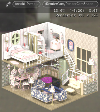

Description of the current render progress: render Status in Solaris showing % render completed, estimated time for completion, time taken for render to complete, and resolution.
It is possible to render inside the Houdini viewport, by switching the viewport Hydra renderer to Arnold. Some of the Arnold renderer options are exposed in the viewport as follows:
