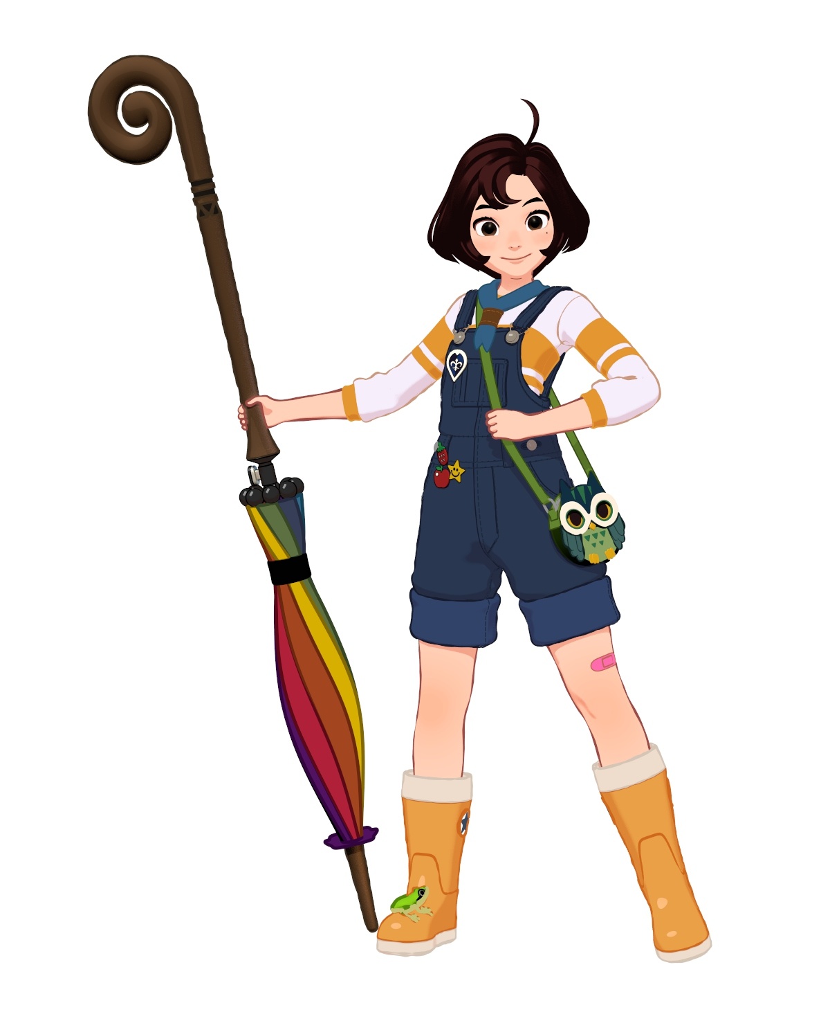

Making of Sophie - Arnold for Houdini
In this 'making of' tutorial, we will break down the steps used to render the image above using the Toon shader. We will cover how to use the Rim Lighting, Base Tonemap, Specular Tonemap, and Stylized Highlight attributes of the Toon shader. We will also cover how to add variation in the Edge Width to create a more illustrative style.
The model has been kindly provided by Jaeyeon Nam. The original concept is by Hong SoonSang.

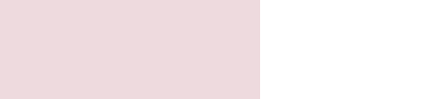

  • To get the highlight on the hair, we will need to connect a ramp to the Specular Tonemap. Change the ramp so that it looks like the ramp below, where white is the highlighted area of the hair. Ensure that there is no interpolation in the ramp, as we want a strong, glossy-looking highlight in the hair.
Without Base Tonemap (default) Ramp -> Base Tonemap

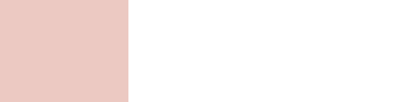

  • Connect a ramp like the one below to the Base Tonemap. Ensure it has a darker skin tone for the Base Tonemap to be visible.

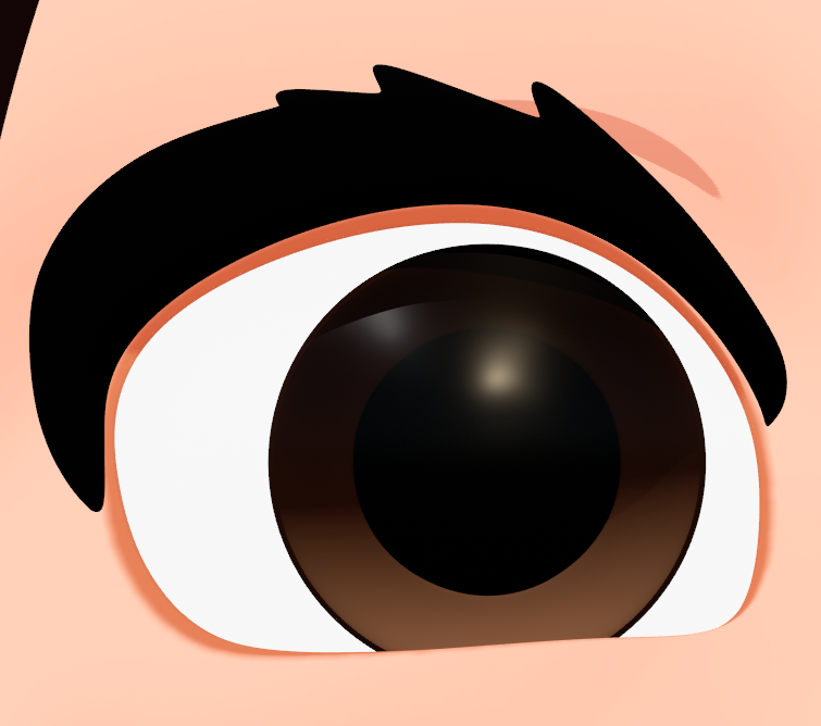

Eyes
Eyeball
  • Assign a Toon shader to the eyeball geometry. Decrease the Base Weight to 0 and increase the Emission Weight to 1. This will give us a pure white color.

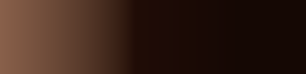

Iris
  • Assign a Standard Surface shader to the iris polygon faces of the eye. We don't need a Toon Edge shader here so a Standard Surface shader should be sufficient.
  • Connect a brown gradient ramp to the Base Color and reduce the Specular Weight to 0 (we will add specularity to the cornea shader).
Cornea
  • Assign a Toon shader to the cornea geometry.
  • Disable Edge as there is already an Edge from where the skin meets the eye.
  • Reduce Base Weight to 0. Change the Specular Color to a dark gray and increase the Specular Roughness to around 0.3.
  • Increase the Transmission Weight to around 0.9 (making it fully transparent would mean there would be no specular highlight).
  • Reduce Indirect Diffuse and Indirect Specular Advanced to 0 (we do not want any indirect shading to occur inside the eyeball).
Eyeball, iris, and pupil geometry

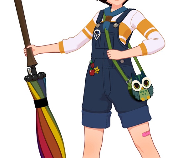

Jumper
  • Assign two Toon shaders to the jumper (one white and one for the orange stripes).
  • Add a light lilac hue to the Jumper's Base Color and an orange color to the stripes Base Color.
  • Connect a ramp to the Base Tonemap (use the same ramp for both shaders).
  • Change the Priority (Advanced Edge Control) of the orange jumper shader to 1. We want it to be greater than that of her skin; otherwise, we will get edges where the jumper meets the skin.
Jumper Priority: 0 (unwanted skin edge) Jumper Priority: 1

Silhouette
Now we are almost there. However, the Toon edge looks too clean and perfect. We need to break up the Edge Silhouette to give the impression that it has been hand-drawn.
  • Enable Silhouette for the dominant shaders such as jeans, boots, stick, etc.
  • Match the Silhouette Color to that of the Edge Color for each shader.
  • Create a Cell Noise shader and connect it to Edge-> Silhouette-> Width Scale. Change the Pattern to Worley1. In this case, the Scale has been changed to 0.2. You may want to experiment with different Pattern and Scale settings depending on the look you are going for. You can also use Offset to change the position of the noise along the Edge. Attributes such as Randomness can have a big impact on the appearance of the Edge thickness.
Cell Noise -> Silhouette Edge Silhouette Edge Only
