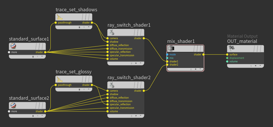

Below is a shading network for a floor material which segregates shadow and specular rays into two different trace sets:

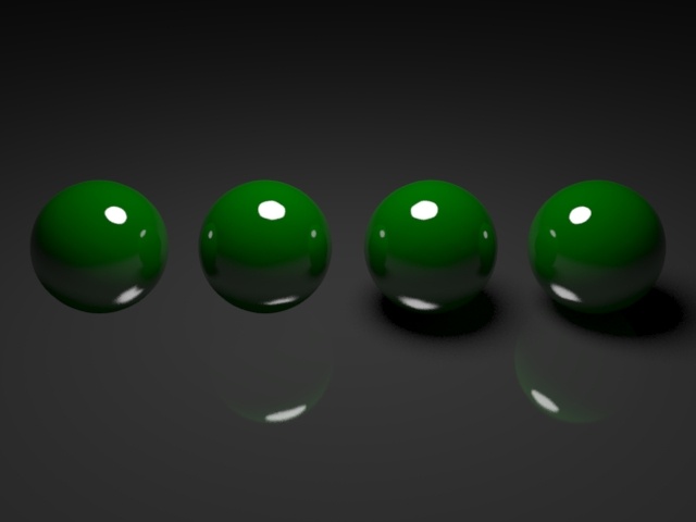

The sphere objects are then tagged to be part of the shadows, specular, or both trace sets:
