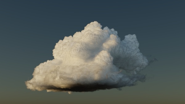

- Connect a physical_sky to the color attribute of a skydome_light. Adjust the elevation and azimuth of the physical_sky to get an interesting lighting effect. Alternatively, you can just rotate the skydome_light in the Y direction.
| Elevation: 45 (default). | Elevation: 10 (sunset). |

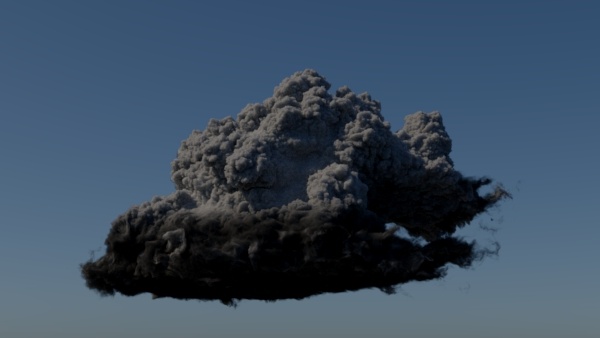

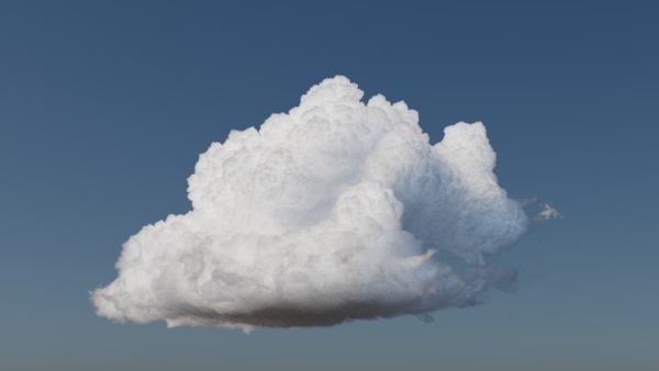

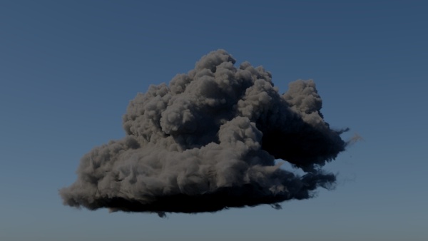

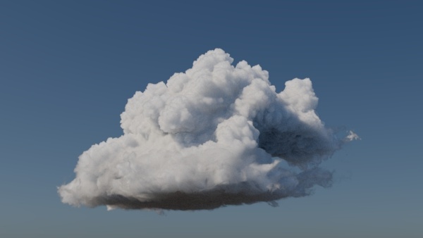

Ray Depth
- Before you start rendering the volume, increase the volume_ray_depth in the render settings to a high value like 50 (remember to increase the total_ray_depth to 50). This is key to achieving the realistic cloud look, as the light will bounce many times inside the volume, making it appear much brighter.
| 0 (default) | 10 |
| 25 | 50 |

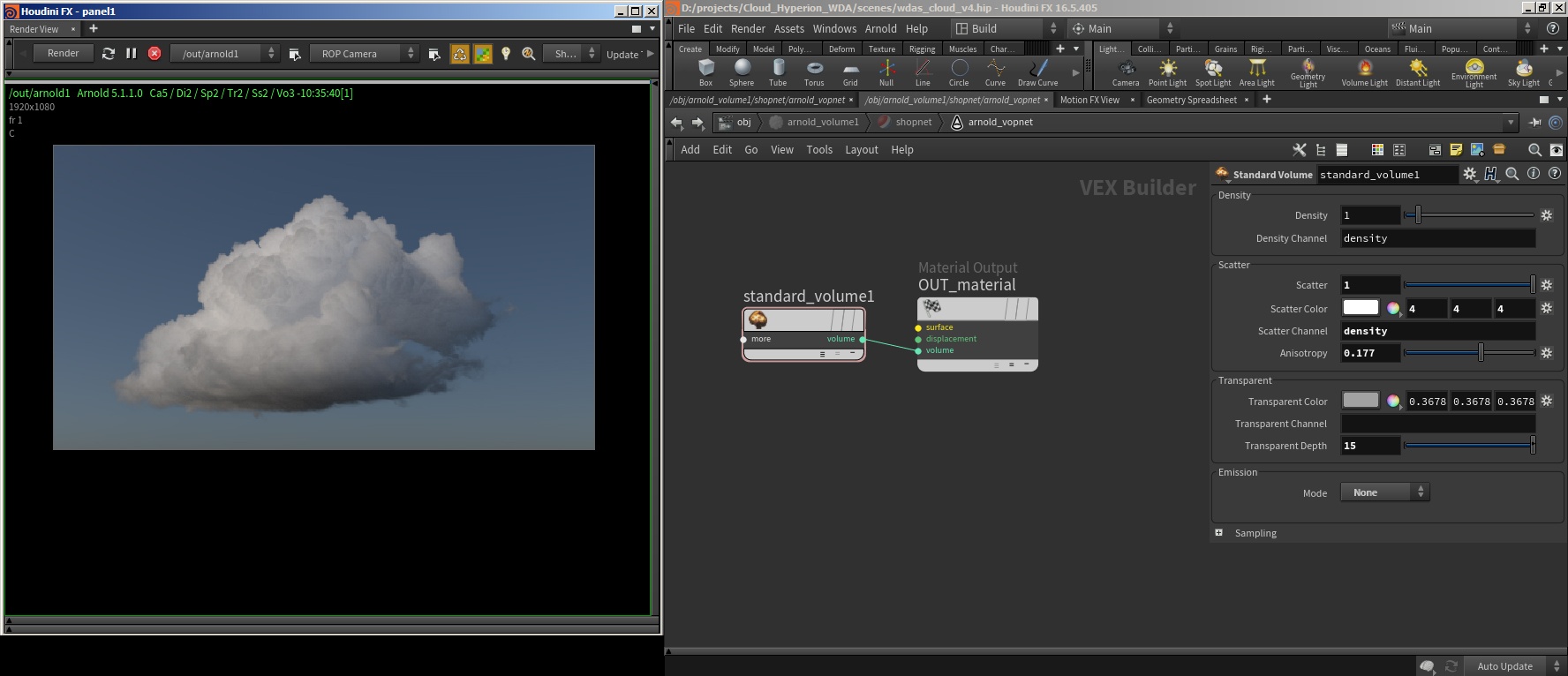

- Create a standard_volume shader and assign it to the volume. The following attributes were adjusted to give the volume the appearance of a cloud.
| scatter_color: 0.5 (default) | 10 |
The scatter slider is maxed to 1. Increasing this value above 1 is a hack and should be used with care. The number should normally be below 1 to be energy-conserving.
Remember to add 'density' to the scatter_color_channel.
| transparent_depth : 1 | 15 |
Transparent_depth controls the depth into the volume at which the transparent_color is realized. Increasing this value gives the volume a much more cloud-like appearance.
Transparency_depth is unit-dependent.
| Transparent_weight: 0.368 | 0.7 |
Increasing transparent_weight allows for more control over the density of the cloud volume.

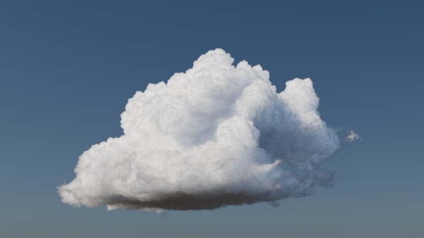

| Density: 1 | 4.3 |
Increasing density gives the cloud volume a thicker appearance.

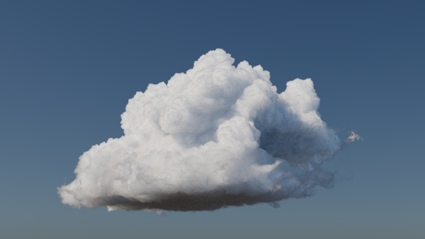

| Anisotropy: 1 (default) | 0.5 |
Anisotropy should be above 0 as clouds are quite strongly forward scattering.

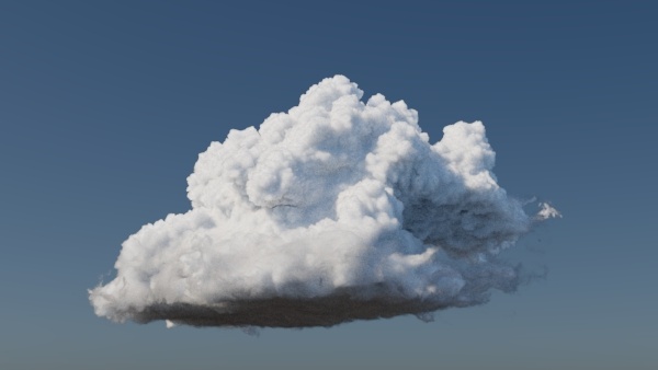

wdas_cloud_sixteenth.vdbwithwdas_cloud.vdb.Bear in mind that this is the full resolution VDB file and so will take longer to render.

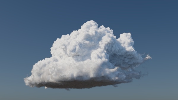

| wdas_cloud_sixteenth.vdb | wdas_cloud.vdb |

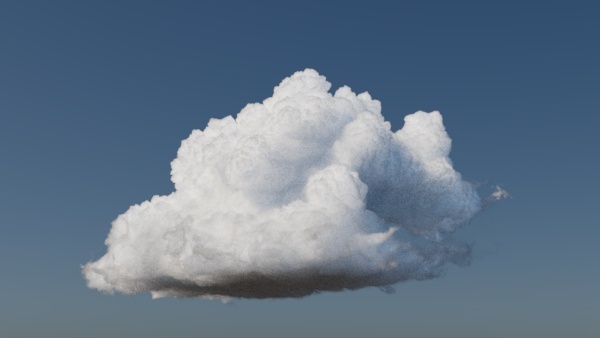

- Under Sampling in the render settings, increase volume_indirect to around 3. This will help to remove noise from the indirectly lit areas of the volume.
| Volume_indirect: 2 | 3 |
