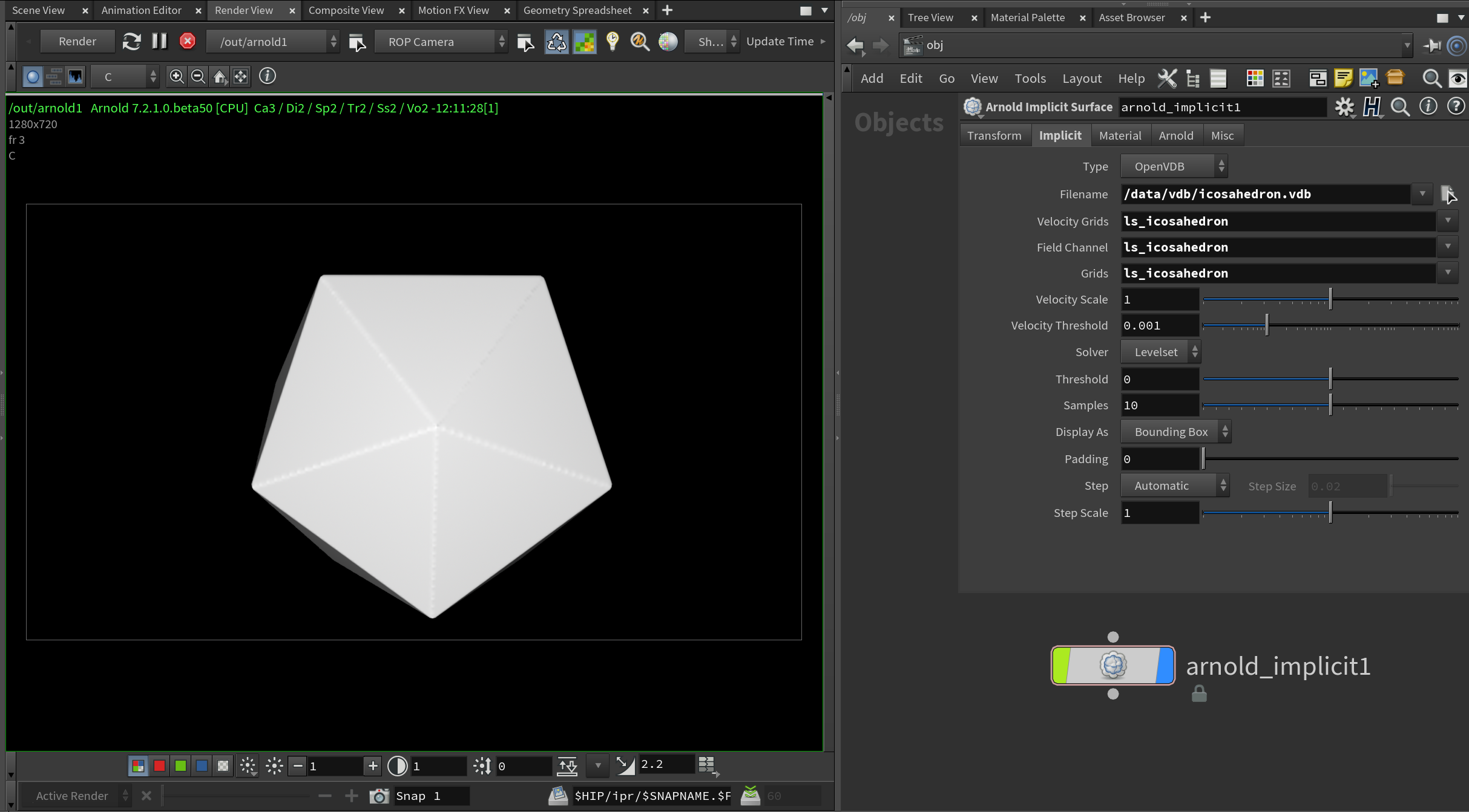

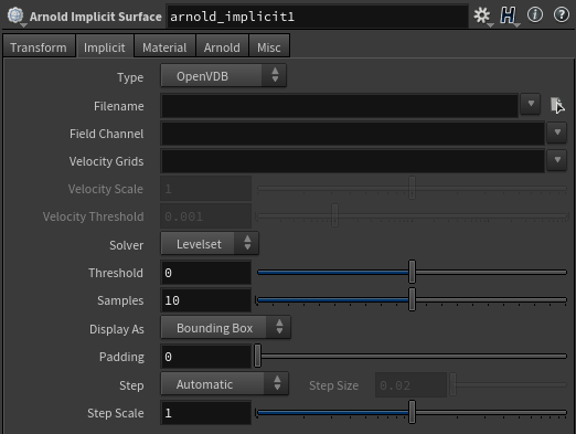

Volume implicit nodes can be used to load volume data from OpenVDB files, or OSL shaders for rendering volumes and implicit surfaces, respectively.
VDB files
| VDB volume rendered as Volume Implicit |

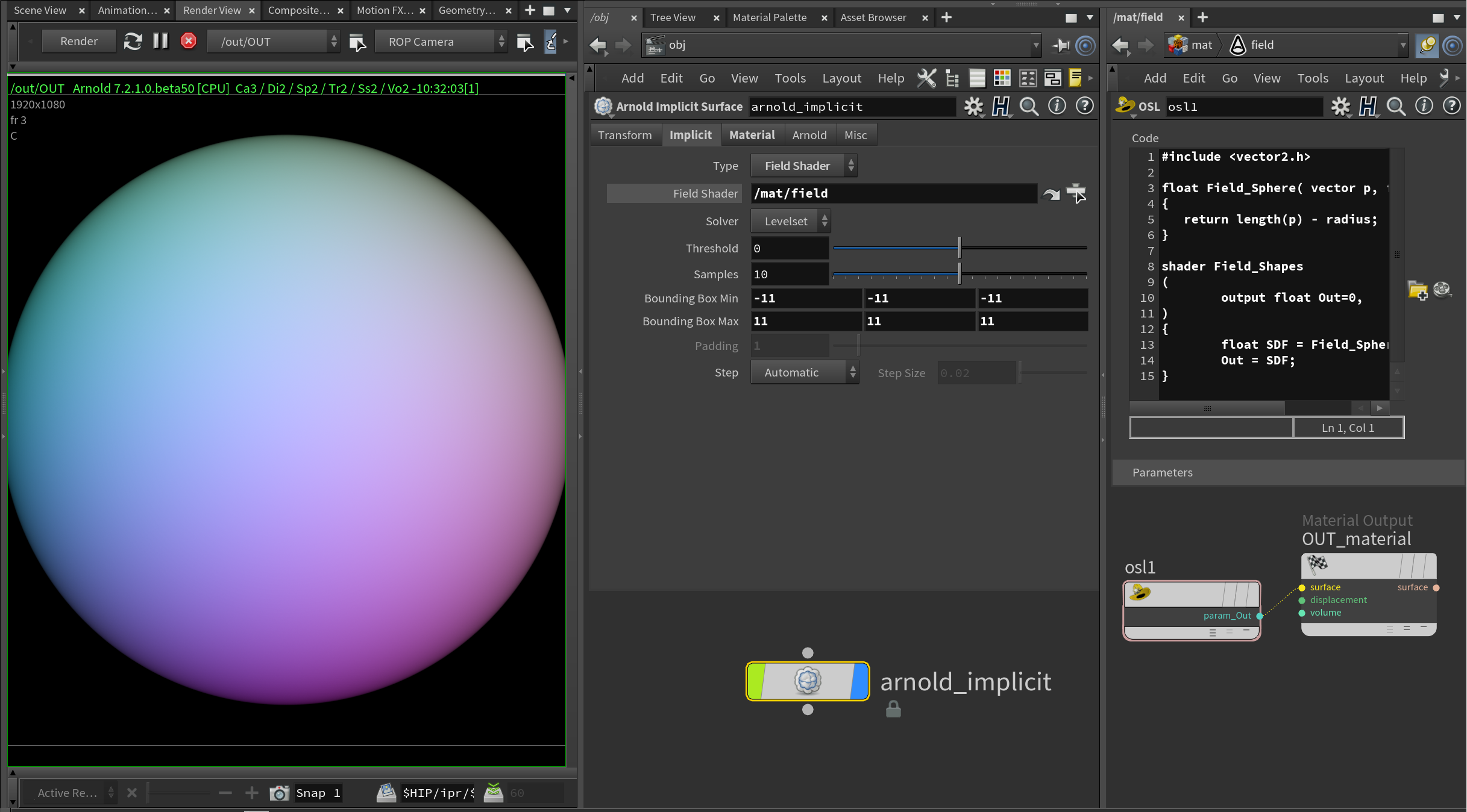

Using Field Shaders
You can connect a custom OSL shader to the volume_implicit.field parameter instead of an input file.
| OSL shader used as input data for Volume Implicit via the Field Shader parameter |
