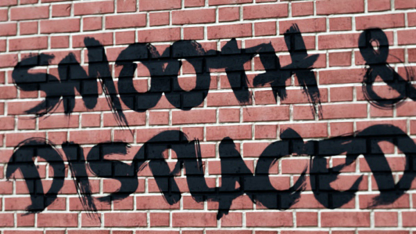

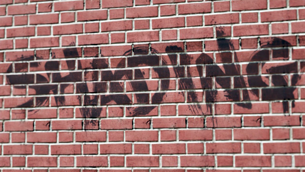

- Various normal types for triplanar: The triplanar shader has a new parameter
normal_typewhich can be used to select the type of normal to use for selecting the dominant axis for texturing. The options areshading, which is the previous behavior and uses the smooth shading normal (this normal includes bump),smooth_and_displacedis like the shading normal but without the bump, and finallysmooth_before_displacinggives the smooth normal before displacement and bump. Note thatsmooth_before_displacingrequires that autobump be enabled. (ARNOLD-15523)
