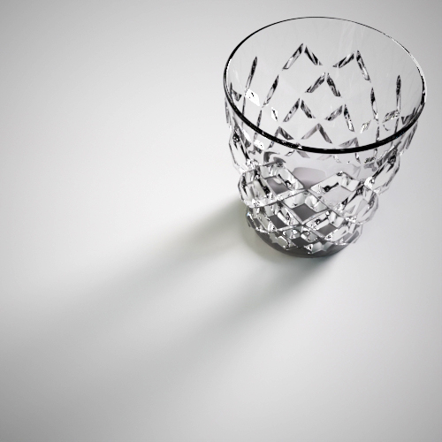

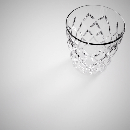

Improved, more realistic shadows for glass objects: Transparent objects like clear glass now cast shadows. The look of the shadow is controlled by the new transmission_shadow_density parameter on the
openpbr_surface
and thestandard_surface
shaders. (ARNOLD-6881, ARNOLD-15863, ARNOLD-15828)
0 | 0.5 | 0.9 | 1 |
transmission shadow density = 0 | transmission shadow density = 1 | |
caustics off | ![]() |
caustics on | ![]() |
