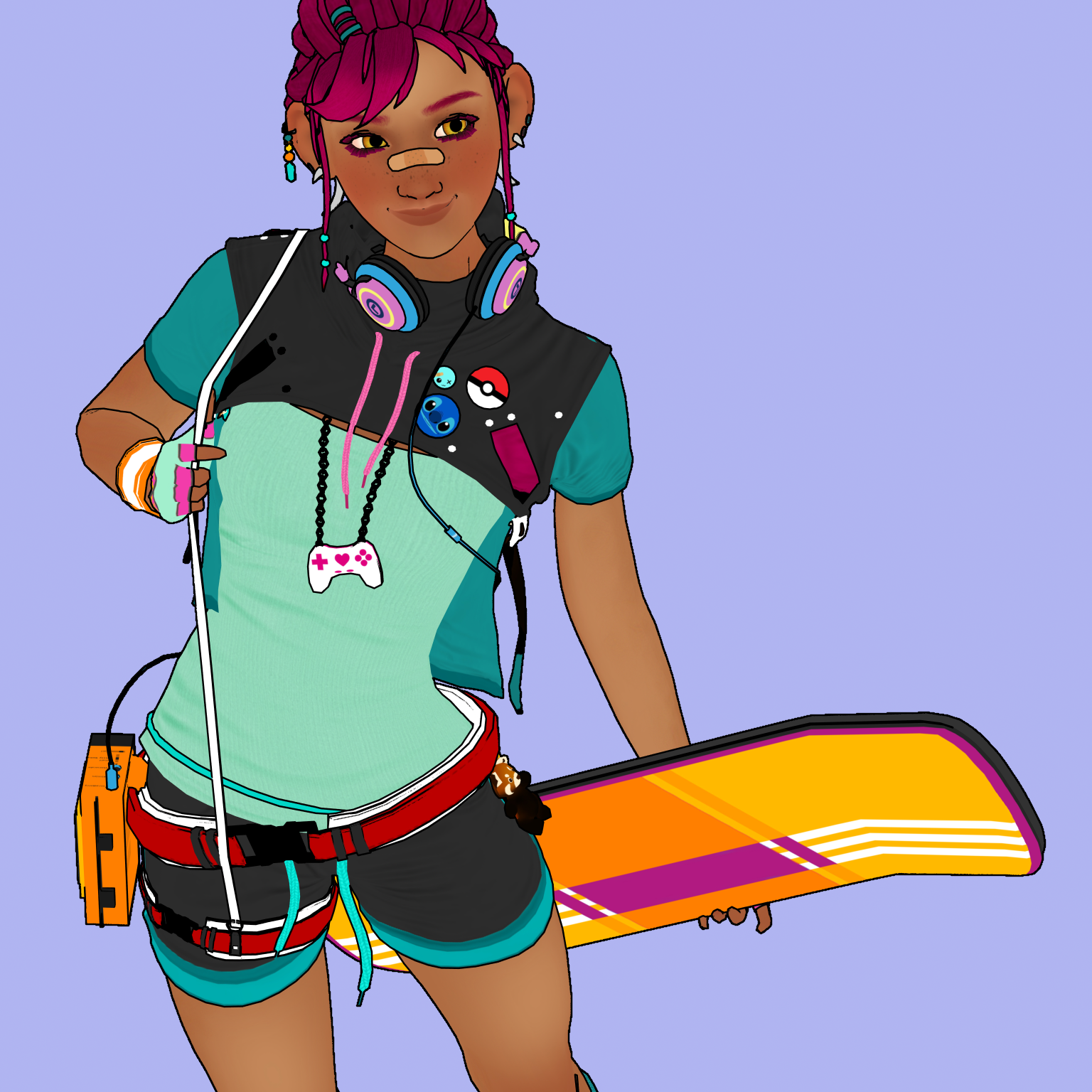

- GPU Toon shading: Arnold GPU now includes initial support for the Toon shader and the contour filter. The Toon shader is currently limited to rendering direct lighting only (no reflections, refractions, or indirect lighting). (ARNOLD-15656, ARNOLD-15988)

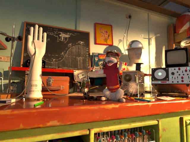

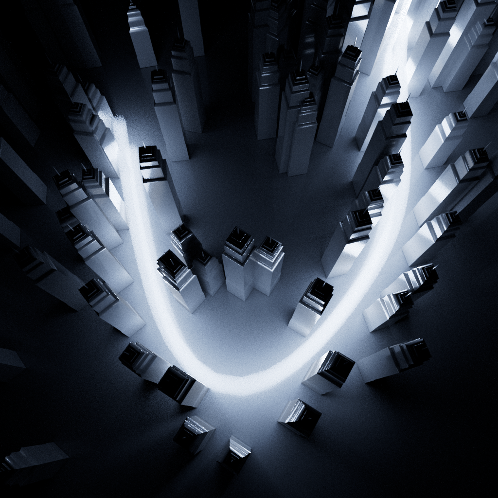

Improved Global Light Sampling: Rendering photometric (IES) lights and mesh lights using Global Light Sampling is now higher quality, using the same render settings and taking the same render times. (ARNOLD-13692, ARNOLD-15859)
Before-and-after comparison: improved renders of various IES profiles (with equal render times and render settings)
Before-and-after comparison: improved renders of a motion-blurred mesh light (with equal render times and render settings)
