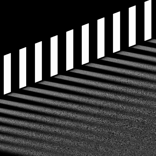

Interactive target FPS: The
ArnoldGlobalSettingsnode has a newinteractive_target_fpsattribute that suggests a frames-per-second target for interactive peformance. Arnold may adjust sampling settings during live rendering in order to reach the target FPS. The final render pass will always use the full sample settings, so this applies only to the blocky progressive passes for scene updates. (KTOA-1176)Increased Global Light Sampling (GLS) robustness and added support for light spread: GLS is now more robust, and GLS takes the
spreadparameter ofquadanddisklights into account. This typically reduces noise when lights have a narrow spread, or the spread is close to the light edges. We have observed up to 6x faster renders in some test scenes with especially tricky lighting. In the below back-alley scene, which has a more common lighting setup with some lights with a spread, this gives a 1.4x-faster render. (ARNOLD-13684, ARNOLD-16610 and ARNOLD-16551)
| 1.4x faster than 7.4.3 |
| 7.4.3.2 | 7.4.4.0 (same number of samples as 7.4.3.2) |

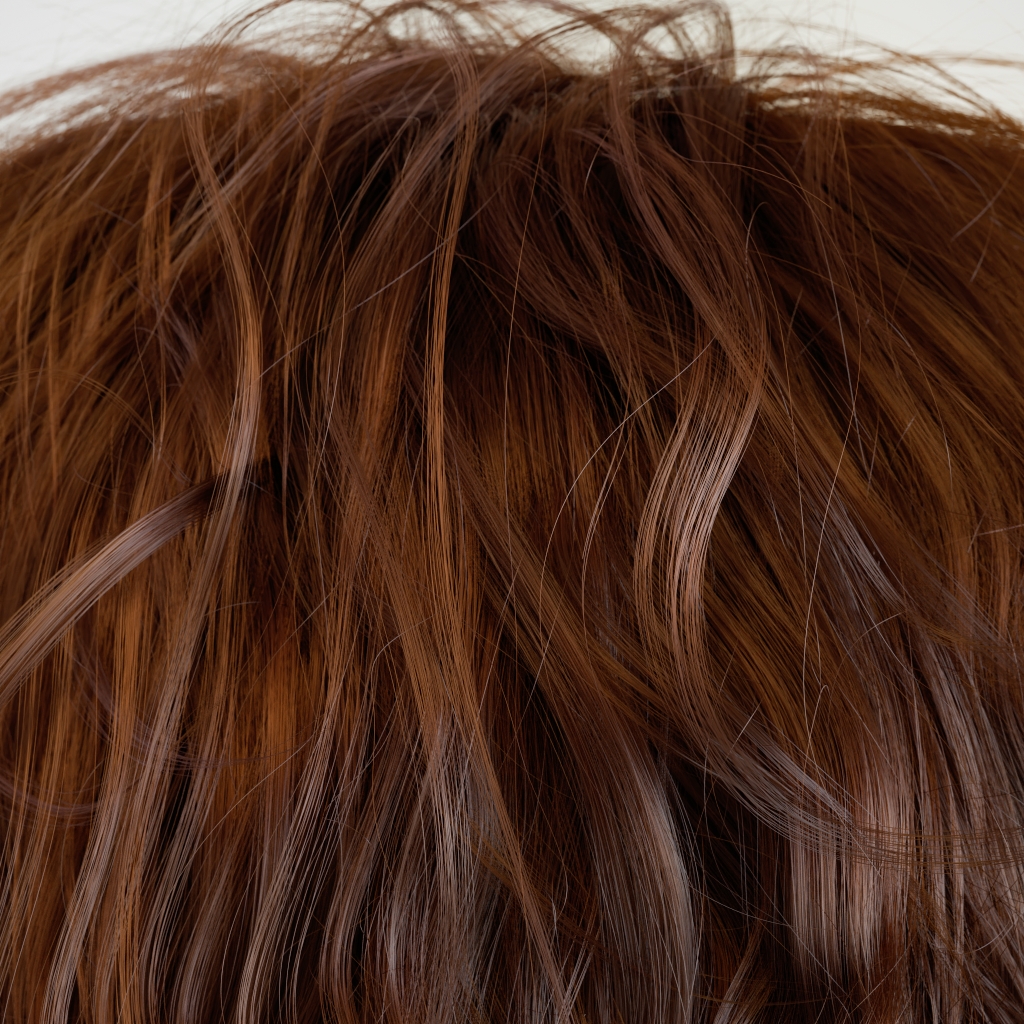

- Scattering mode for standard hair: A scattering option
scattering_modehas been added to the standard hair shader. Use theapproximatemode to get the previous behavior. Theaccuratemode can be noisier, and so takes about 10 to 30% longer to render, but delivers more realistic results, especially in close-ups, by simulating each hair as a cylinder instead of flat surface. Theadaptivemode uses theaccuratemode for close-up hairs and theapproximatefor far-away hairs, automatically balancing quality and performance. (ARNOLD-16726, ARNOLD-16852)
| approximate | accurate | approximate (closeup) | accurate (closeup) |
| adaptive |

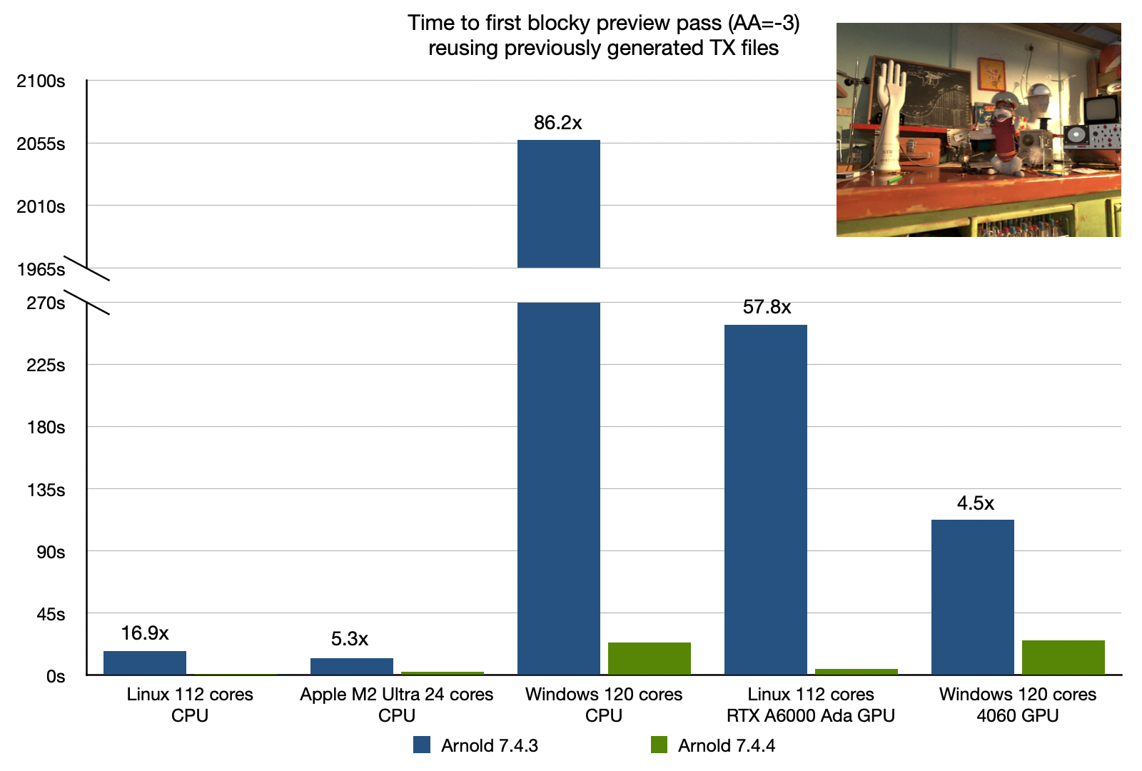

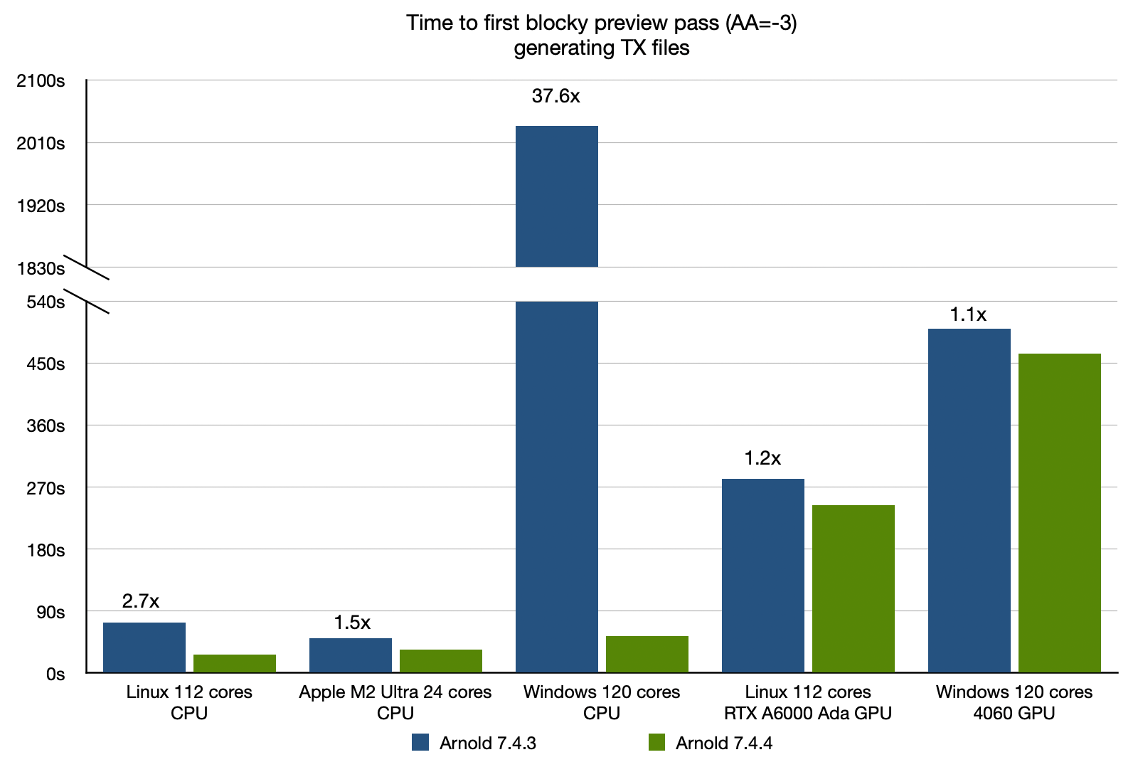

- Improved performance when auto-generating or using existing TX files:
Checking for existing TX files and auto-generating missing ones is now significantly faster, reducing time-to-first-pixel when using
texture_use_existing_txortexture_auto_generate_tx. As the charts below show, speedups are most pronounced on many-core machines, particularly on Windows. (ARNOLD-13116)
texture_auto_generate_tx speedup |
texture_use_existing_tx speedup |

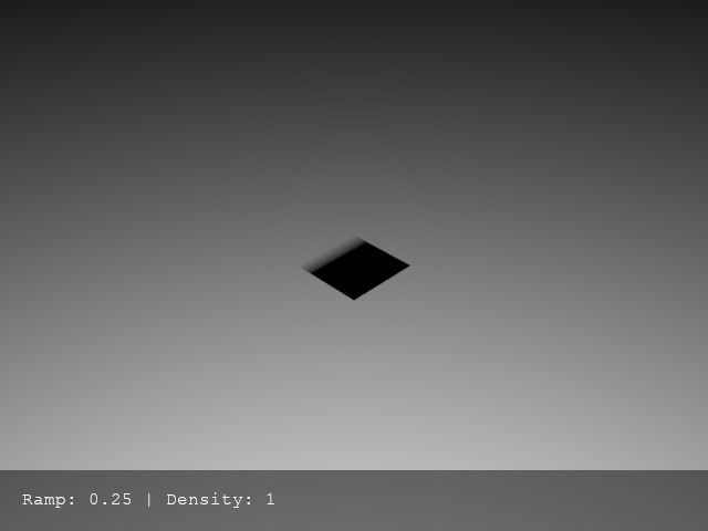

Light blockers with negative density: Light blockers with ramps and negative density values are now supported. (ARNOLD-16338)

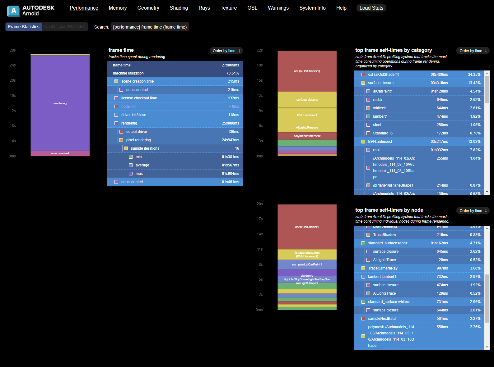

Separate statistics for frame and session data: During interactive renders, Arnold now tracks two types of statistics: per-frame for individual frame renders and per-session for accumulated values normalized across the entire render session. The log outputs statistics for each frame in addition to the session statistics, while statistics JSON files contain the final frame statistics and session statistics. This separation helps a user analyze both the performance of individual frames and the overall render session. (ARNOLD-16735)
Render Report: enhanced statistics visualization: The Arnold Render Report now displays both per-frame and session statistics during interactive renders. Additional improvements include stacked bar graphs for better visualization of these statistics and other user experience enhancements. (ARNOLD-16736)
