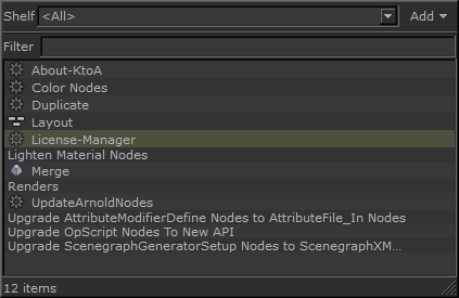

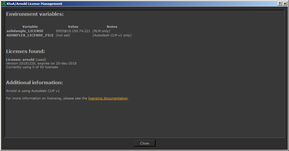

License Management Shelf Script
There is a license manager shelf script for KtoA, which shows the current licenses available and any environment variables that affect licensing.
