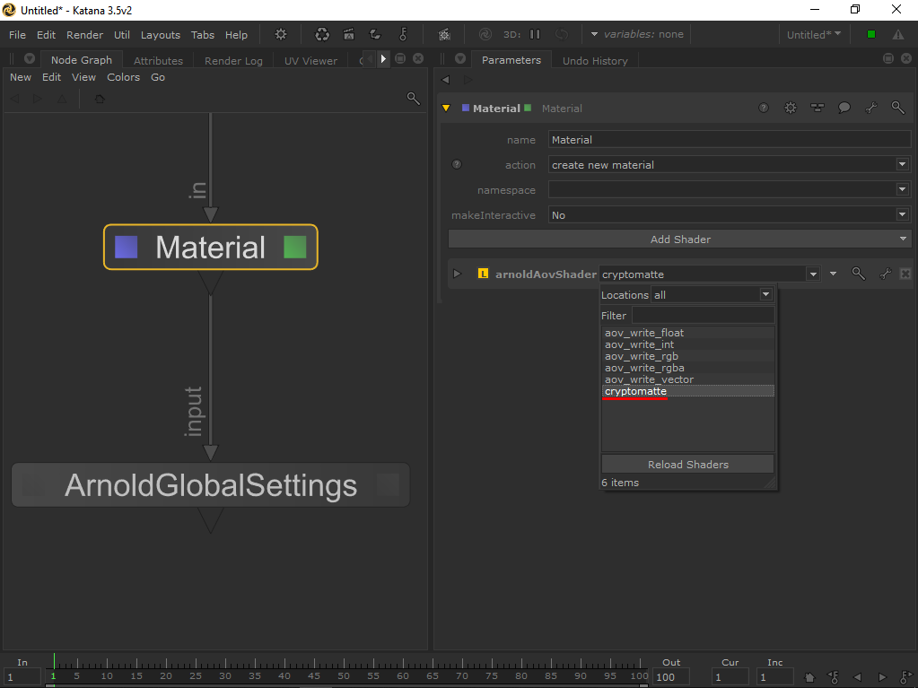

- Create the cryptomatte material and assign it to an arnoldAov shader slot.

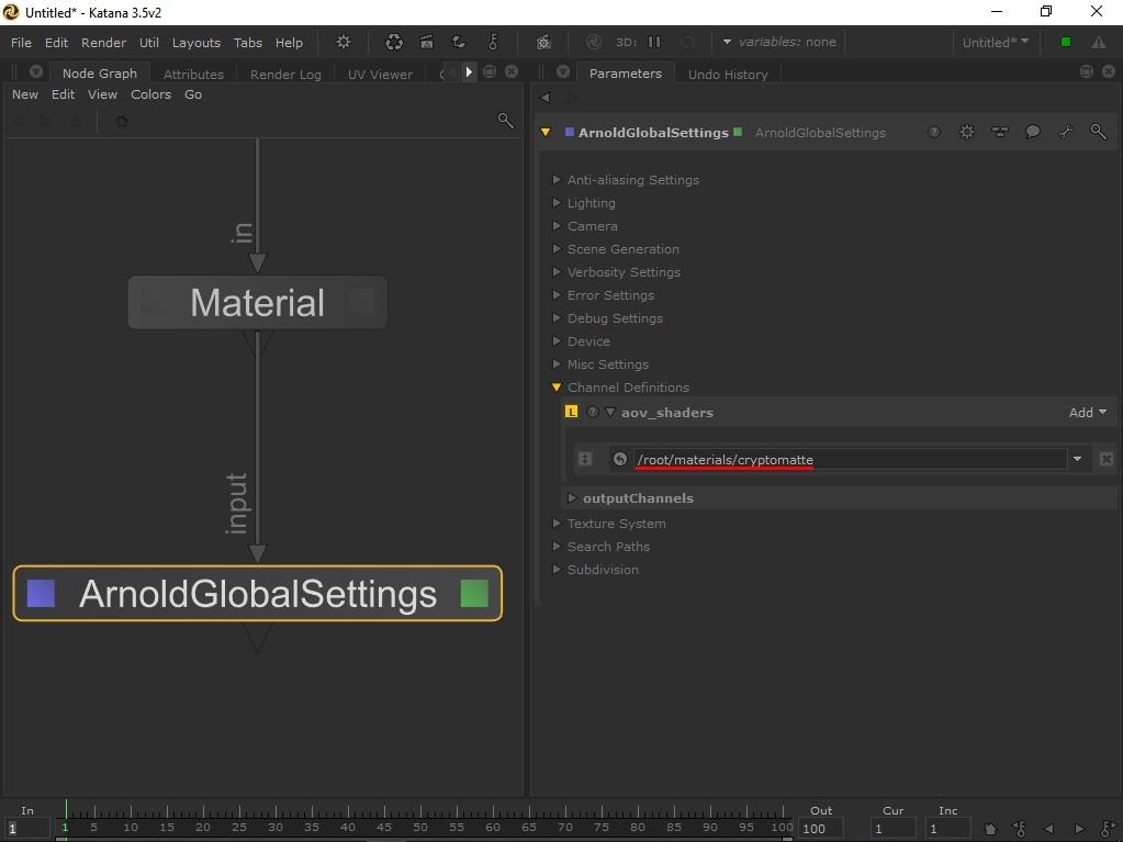

- Set the cryptomatte material on an ArnoldGlobalSettings node, in Channel Definitions -> aov_shaders (add an entry and assign your cryptomatte material).

| Material node: AOVs shader -> cryptomatte | ArnoldGlobalSettings: add the cryptomatte shader to AOV shaders |
