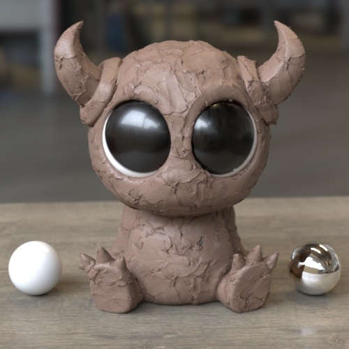

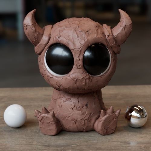

| sRGB | ACES |
This tutorial provides information on how to configure Color Management to work with the OpenColorIO implementation of the Academy Color Encoding System (ACES), as well as a summary of what ACES is. The article is divided into two parts: theoretical and practical. The theoretical part will help you understand some of the basics of ACES, and how it works, before you get down to the practical part, and consider some of the nuances in setting up Color Management.

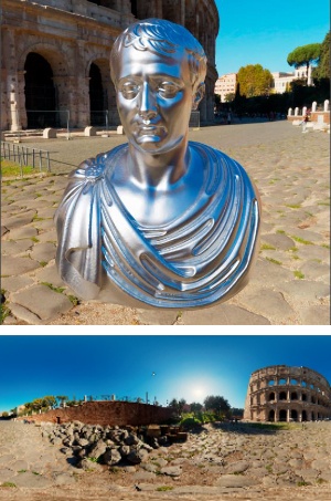

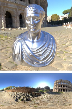

| Linear HDR Map | Linear HDR map opened as ACEScg (incorrect) | Linear HDR map converted to ACEScg (Utility-Linear-Rec.709 or sRGB) (correct) |
