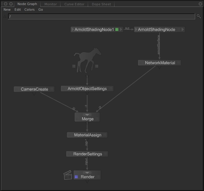

To create a shader network material and assign it, you must create one or more nodes of type ArnoldShadingNode, one NetworkMaterial node, and one MaterialAssign node. In the NetworkMaterial node parameters (green highlight), you should click the Add Terminal button, and choose the type you desire. Let's use the Arnold Surface type, as there are other types available that we don't need yet. It creates an input port on top of the node that you will be able to connect a shader network to later:

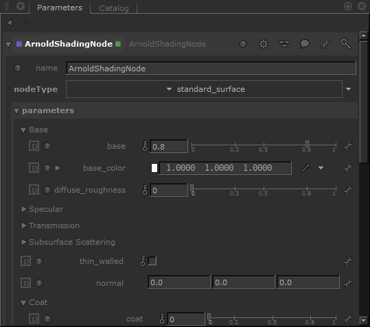

Next, edit the ArnoldShadingNode parameters. Click the nodeType drop-down, and select standard_surface . It should build a list of parameters for the Arnold built-in standard shader; set them how you like (for example, decrease specular to 0.3):
At this point, you could experiment; try adding another ArnoldShadingNode to your node graph, set its nodeType to noise, increase its octaves (to say, 3), and decrease its scale (to say 0.1 in each dimension), to make it more interesting. You should then plug the nodes together:
  • Noise shader node output (out) into the standard shader node input (Kd)
  • Standard shader node output (out) into the NetworkMaterial surface input
  • NetworkMaterial output into the Merge node
Your node graph should look like this:

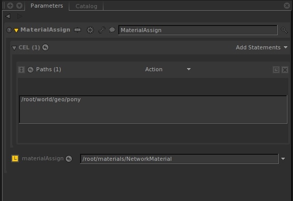

Finally, for the material, we must assign it. Edit the parameters of the MaterialAssign node, middle-mouse dragging the pony from the Scene Graph tab to the CEL Add Statement text again. Then, expand the materials group in the Scene Graph tab and middle-mouse drag NetworkMaterial to the materialAssign field (not the text) in the Parameters tab. The parameters should look like this:

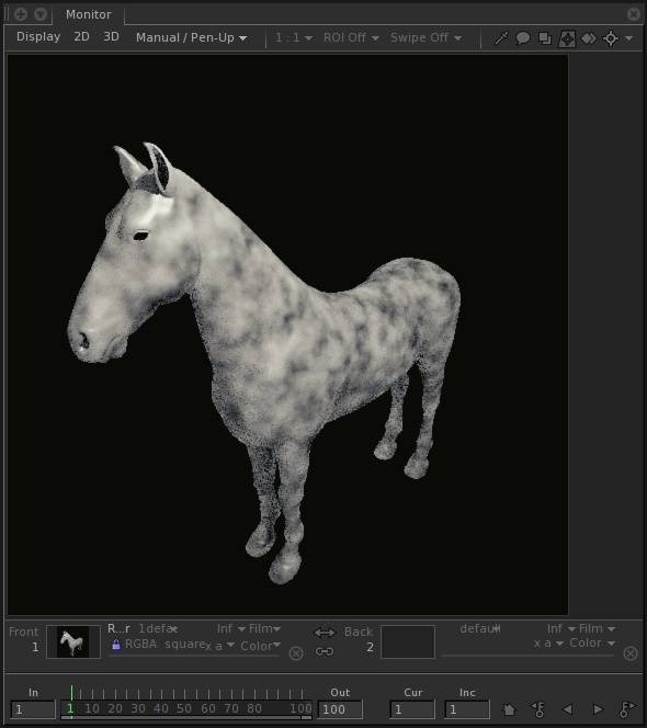

Finally, right-click it and kick off a Preview Render (switch again to the Monitor tab to see the results). It should look like this:
To increase the render quality and remove the noise, create an ArnoldGlobalSettings node, insert it in between the RenderSettings and Render nodes, and set the Anti-aliasing Settings -> AA_samples to 4:
