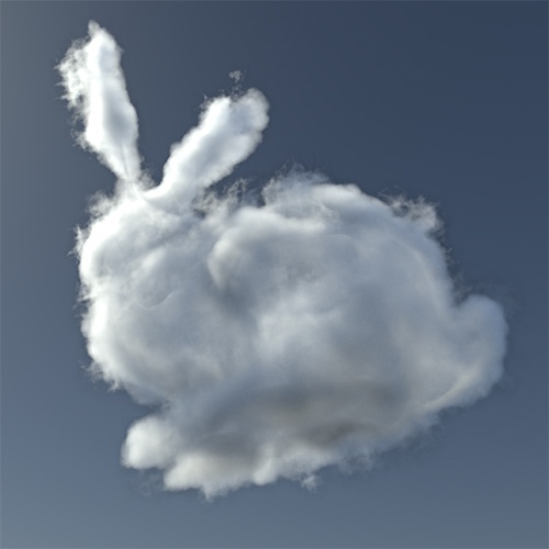

Arnold OpenVDB Volume - Arnold for Katana
Volume file formats, such as OpenVDB, will allow storage of much larger datasets while being optimized for random access to volume data, which is more efficient for rendering.
OpenVDB is an open source C++ library comprising a novel hierarchical data structure and a suite of tools for the efficient storage and manipulation of sparse volumetric data discretized on three-dimensional grids.
