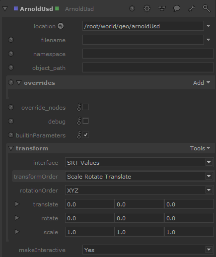

A procedural node that is capable of reading USD files.
Filename
The path to the USD file.
Namespace
Create nodes in this namespace if present.
Object Path
Determines which USD primitive(s) are rendered. When empty (default), it will render the whole USD file.
Override Nodes
Serialized changes to be applied on top of the USD file, in USD ASCII format.
Debug
Enable extra debugging log output when loading the USD scene.
Built-in Parameters
Whether to include the built-in Katana parameters (frame, shutter, cropwindow, katanaFullName) as user data on the procedural or not.
