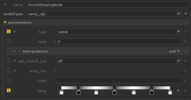

- Connect a ramp RGB to the specular anisotropy parameter.
- Change the ramp RGB Type to radial. Insert four black and four white colors into the ramp. Change their interpolation to smooth.

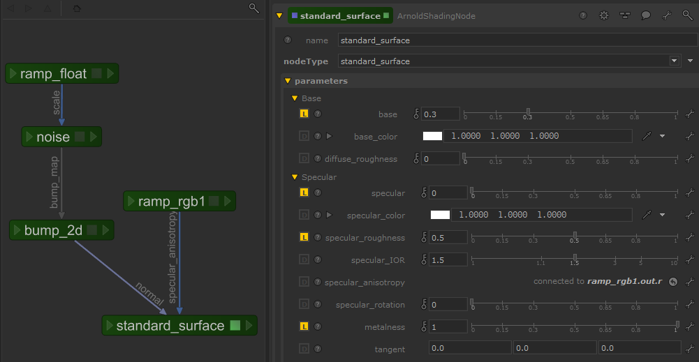

ramp RGB -> specular anisotropy of standard surface
Bump Map
Now we need to create a scratch effect and connect it to the bump attribute to achieve a subtle brushed metal effect. We can do this using the following shaders:
RampFloat -> Noise -> bump2d
- Create a bump2d and connect it to the normal camera of the pots base shader. Set the bump height to around 0.5.
- Create a noise shader and connect it to the bump map of the bump2d. Change octaves to 8 and amplitude to around 0.4.
- Create a ramp float and connect it to the scale of the noise shader. Change the type to circular. This will give us the concentric ring effect that we want.

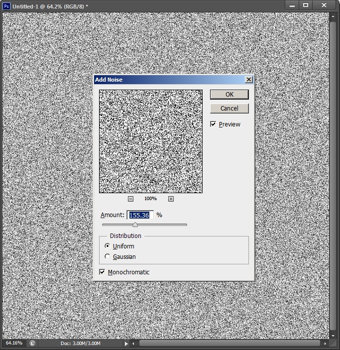

- Go to Filter-> Noise-> Add Noise to add some noise to the image.

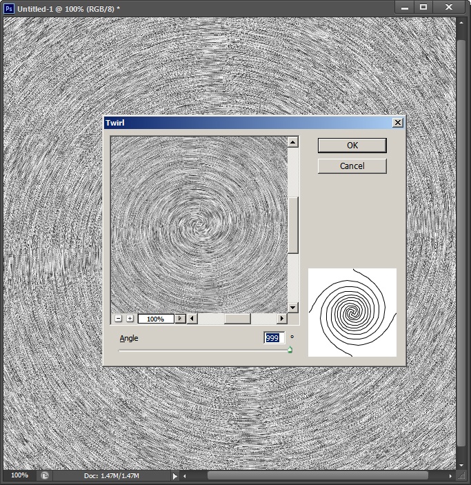

- Go to Filter-> Distort-> Twirl to add a circular effect to the noise. You may need to do this two or three times to get the desired effect. Crop the image and save it.
| Noise filter in Photoshop | Twirl filter in Photoshop |

Final shading network
