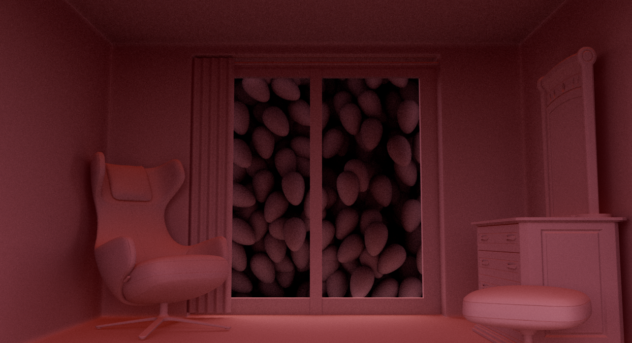

The scene above contains balloons that are flying past a window and filling the room with color. This tutorial will show you how to create this caustic balloon effect using a gobo light filter connected to a spot light pointing through the window. We will also cover the shading steps used for the balloons. Thanks to Slava Sych for this tutorial.

Skydome lighting. The window glass is hidden, and shadows are disabled for the balloons.
