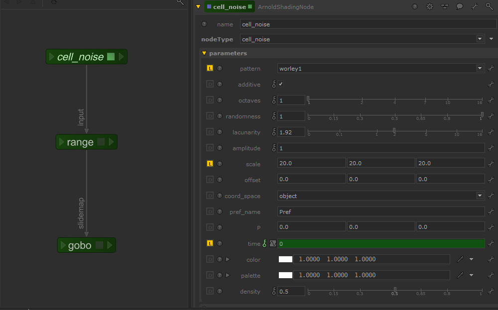

  • Connect a cell noise shader to the blend attribute of the gobo.
Cell Noise
  • Change the cell noise pattern to worley 1.
  • Increase the cell noise scale. In this case, 20 was used in XYZ.
  • Change the coord space to uv. This uses the object's local UV coordinate, and in this case, looks better for the effect that we want to achieve.

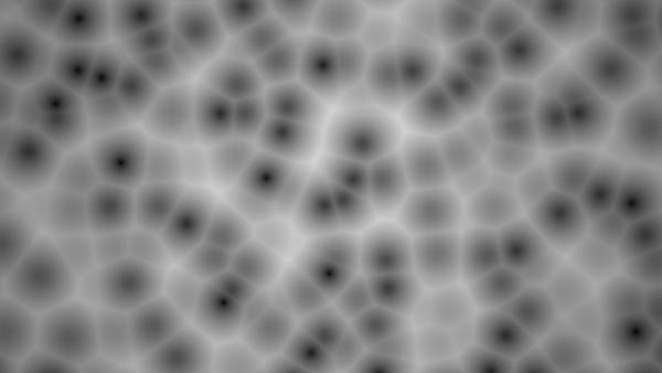

cell noise shader using the worley 1 pattern

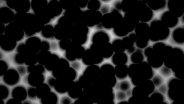

  • Insert a range shader in-between the cell noise shader and the gobo.
  • Enable smoothstep in the range shader.
  • Increase the input min attribute and notice its effect on the cell noise shader.
input min increased to 0.6
  • Reduce the bias to around 0.01. You should notice that it now looks more like a caustic effect.
Bias reduced to 0.01
