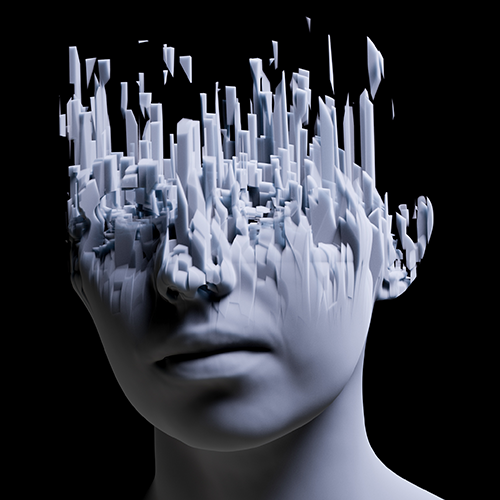

Polymesh objects can be rendered as volumes. This gives many creative opportunities for rendering solid objects in varied and interesting ways. This short 'making of' tutorial shows how to combine a Polymesh with a Volume by combining their shading using the displacement attribute of a Standard Volume shader. We will also cover how to reproduce the above-animated effect using the Cell Noise, Color Correct, Ramp RGB, and Range shaders connected to Volume Displacement of the Standard Volume shader. An example of a free-to-use head scan model can be found here.

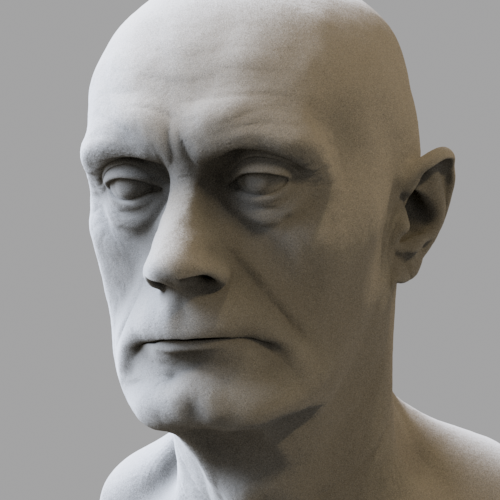

  • First of all, we need to convert the head mesh to a volume. Select the mesh and under its Arnold attributes, increase the Step Size to 0.1. When the Step Size is positive, it turns a polymesh into a volume, and its value is used as the base step for raymarching the volume.
Note:
More information about volume Step Size can be found here.
Standard Volume
  • Assign a Standard Volume shader to the polymesh and increase the Density to a very high value of around 4000. This will ensure that the displacement texturing looks more defined later.
Head mesh rendered as volume

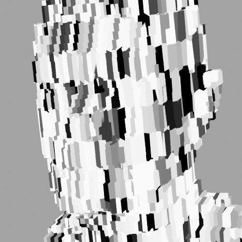

Cell Noise
  • Create a Cell Noise shader.
  • Change the Pattern to Cell1.
  • Disable Additive.
  • Ensure that the Coord Space is set to Object.
  • You will need to adjust the Scale according to your scene size. In this case, the Cell Noise is thinner because Y and Z are less than X.
  • Increase the Density to 1 and set Randomness to around 0.2 to add some irregular shapes.
Final Cell Noise settings
Animation
  • Keyframe the black color of the Ramp RGB from left to right over time to see the effect move from bottom to top across the head volume.
  • Keyframe the Time attribute of the Cell Noise shader to animate the Cell Noise effect.
Conclusion
That's it. Remember to increase the Volume Samples for any lights in the scene when rendering the final animation.
Further example with Cell Noise scaled in Y
