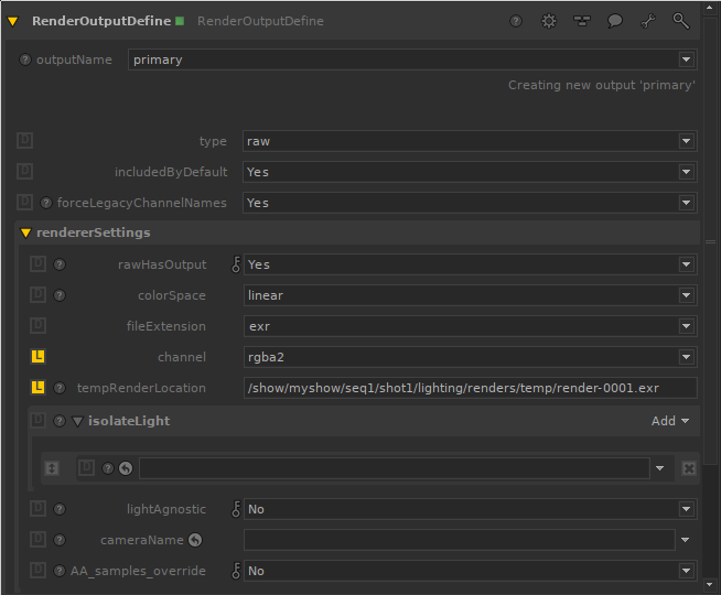

Each render output (which has one output channel it pulls from) will need an explicit RenderOutputDefine node. In it, you will need to select the channel defined in the corresponding ArnoldOutputChannelDefine. You can set the tempRenderLocation parameter to anything you like or even leave it empty. When that temporary location is left empty, Katana auto-generates a location within its temp session directory (for example, located in /tmp/katana_tmpdir_6142), but when the render exits in any way, it will delete the temporary render file. KtoA attempts to ensure any already-rendered tiles in the temporary file are copied to the final location, so any partial progress will be kept.
