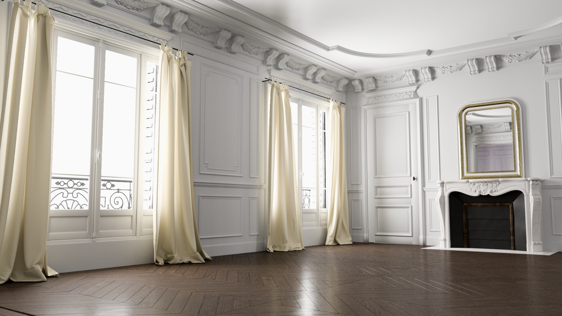

This tutorial will look at various ways to reduce noise in a Parisian interior room scene. Typically, a large number of Diffuse Samples is required to reduce the indirect noise in an interior. However, render times can increase dramatically with high Diffuse Samples. We will, therefore, look at denoising (OptiX™ denoiser and the Arnold denoiser) to reduce the noise without having to use such a high number of Diffuse Samples.
Denoisers consider a neighborhood around the current pixel and look for similar neighborhoods inside a given search area to blend together.
The room is lit using a Skydome Light (at least 3 samples recommended) with a Light Portals positioned outside of the window. Note that the above final image uses a Diffuse Ray Depth of 4, whereas the test images below use a Diffuse Ray Depth of 1 and therefore appear darker. Also, note that Camera (AA) samples have been set to 6 for all renders.
The OptiX™ denoiser is more suited to IPR rendering.
More information about the OptiX™ denoiser and the Arnold denoiser is available here.

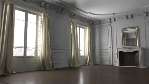

Diffuse Samples: 2 (default)
Now we will render the scene using the default Diffuse Samples (2). It is very noisy, especially in the indirectly lit wall on the left. We can see that the OptiX™ denoiser struggles to produce a clean image with such a low number of Diffuse Samples.
| Without Optix | With Optix |
The Arnold denoiser fares better, but there is still some 'splotchy' noise visible, especially on the indirectly lit wall.
| Without Arnold Denoiser | With Arnold Denoiser |
Diffuse Samples: 5
Increasing the number of Diffuse Samples improves the noise. Note that increasing this value starts to increase the render time. However, the OptiX™ denoiser still cannot resolve the noise well.
The Arnold denoiser produces a superior image. In most cases, this would be adequate. Let's try increasing the number of Diffuse Samples even further and see what we get.
Diffuse Samples: 10
With Diffuse Samples set to 10, we get a much cleaner image. However, our render times have increased significantly as a result. Notice how the OptiX™ denoiser affects the thin geometry of the window balcony. The Arnold denoiser does a much better job of dealing with these areas.
