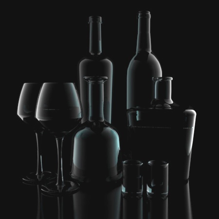

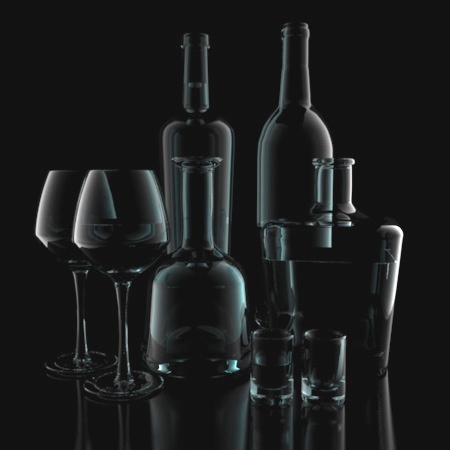

Transmission Depth
Correct Transmission Depth settings are important for achieving realistic glass and water effects. Bear in mind that higher values will increase render time.
By default, Arnold uses a Transmission Depth of 8.
| 2 | 4 | 8 (default) |
The scene below contains many glass surfaces. Increasing the Transmission Depth reveals more detail in the refracted glass.

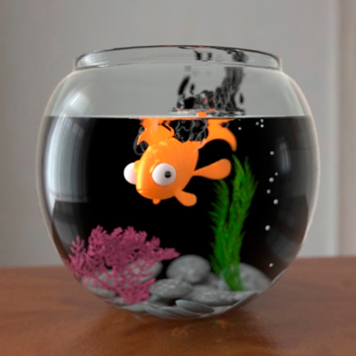

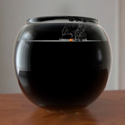

| 2 | 4 | 6 |
Total Depth
When increasing ray depth settings, make sure that the total depth is set high enough to include the Transmission Depth.
The total depth specifies the total maximum recursion depth of any ray in the scene (diffuse + transmission + specular < Total).

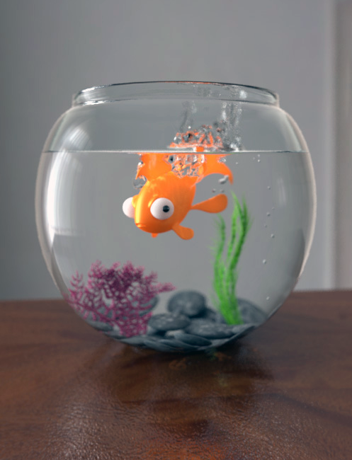

Final Render
Here is the final image. The Transmission Depth has been left at the default value of 8. Higher values may be required to reduce further areas in the splashed water where the render appears solid black.
