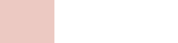

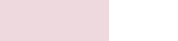

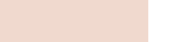

Skin
  • Assign a Toon shader to the head and body geo and rename it Skin.
  • Connect the map test_diffuse..tif to the Base Color.
  • Connect a ramp like the one below to the Base Tonemap. Ensure it has a darker skin tone for the Base Tonemap to be visible.
Without Base Tonemap (default) Ramp -> Base Tonemap

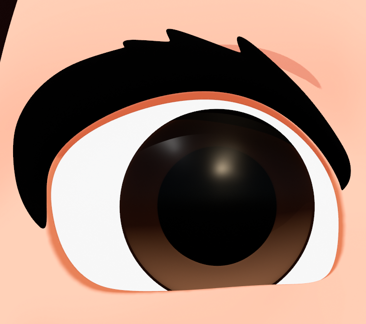

Eyes
Eyeball
  • Assign a Toon shader to the eyeball geometry. Decrease the Base Weight to 0 and increase the Emission Weight to 1. This will give us a pure white color.
Iris
  • Assign a Standard Surface shader to the iris polygon faces of the eye. We don't need a Toon Edge shader here, so a Standard Surface shader should be sufficient.

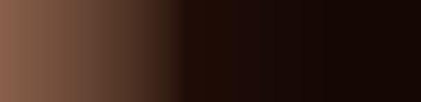

  • Connect a brown gradient ramp to the Base Color and reduce the Specular Weight to 0 (we will add specularity to the cornea shader).
Cornea
  • Assign a Toon shader to the cornea geometry.
  • Disable Edge as there is already an Edge from where the skin meets the eye.
  • Reduce Base Weight to 0. Change the Specular Color to a dark gray and increase the Specular Roughness to around 0.3.
  • Increase the Transmission Weight to around 0.9 (making it fully transparent would mean there would be no specular highlight).
  • Reduce Indirect Diffuse and Indirect Specular (Advanced) to 0 (we do not want any indirect shading to occur inside the eyeball).

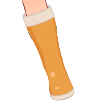

Boots
  • Assign a Toon shader to the plastic orange boot.
  • Connect a ramp to the Base Tonemap.
To get a glossy highlight on Sophie's boots, we can use stylized_highlight.
  • Create a directional (distant) light and angle it in a similar position to the physical_sky (you will need to do this by eye).
  • Under stylized_highlight enter the name of the directional light (this may vary according to which Arnold plugin you are using.) Check the toon documentation for the correct naming convention. For example, in MtoA, it would be directionalLightShape1
  • Increase the size of the stylized_highlight to around 0.2.
Stylized Highlight on boot

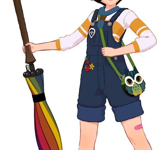

Silhouette
Now we are almost there. However, the Toon edge looks too clean and perfect. We need to break up the Edge Silhouette to give the impression that it has been hand-drawn.
  • Enable Silhouette for the dominant shaders such as jeans, boots, stick, etc.
  • Match the Silhouette Color to that of the Edge Color for each shader.
  • Create a Cell Noise shader and connect it to Edge-> Silhouette-> Width Scale. Change the Pattern to Worley1. In this case, the Scale has been changed to 0.2. You may want to experiment with different Pattern and Scale settings depending on the look you are going for. You can also use Offset to change the position of the noise along the Edge. Attributes such as Randomness can have a big impact on the appearance of the Edge thickness.
Cell Noise -> Silhouette Edge
