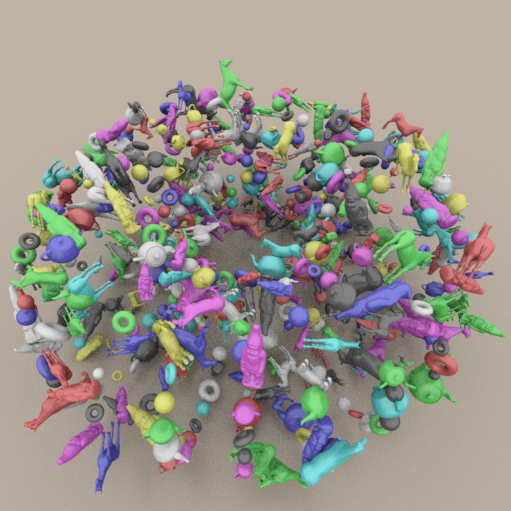

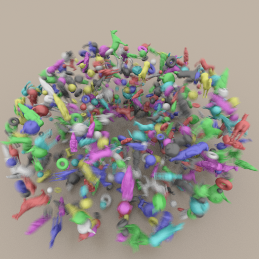

The scene should be set up normally, with motion and animation defined as they normally would be. In this example, we have motion generated by a script and then applied to the vertices of various instanced objects. The true motion blur takes this static scene and motion-blurs it as follows:

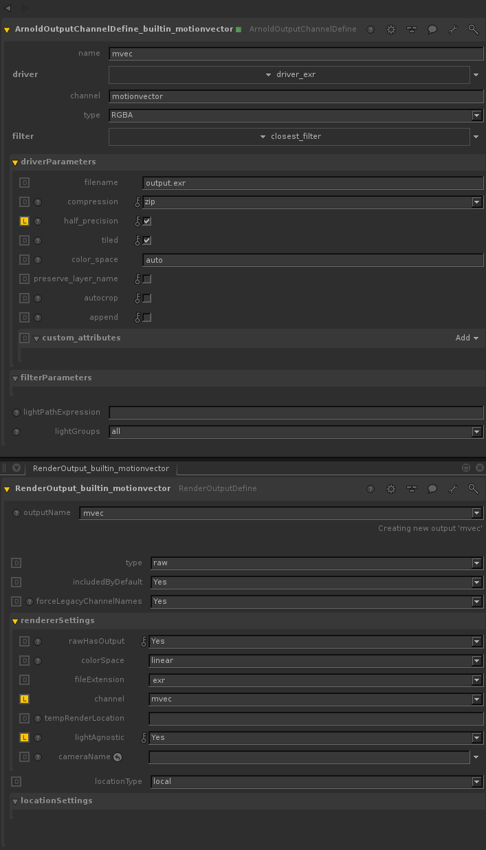

Motion Vector AOV
Arnold provides a built-in AOV for motion vectors. By creating ArnoldOutputChannelDefine and associated RenderOutputDefine nodes, both the regular primary (unblurred) output and the motion vector data can be rendered in a single pass:

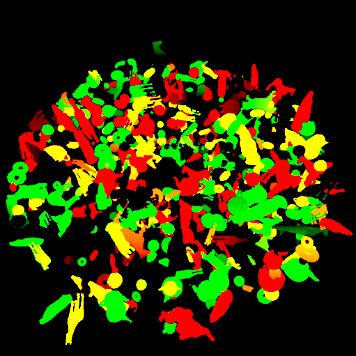

Motion vectors visually end up appearing like the following, and the EXR results can then be used to blur the primary RGBA output:
