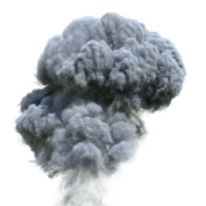

Volume VDB rendered in Arnold Volume

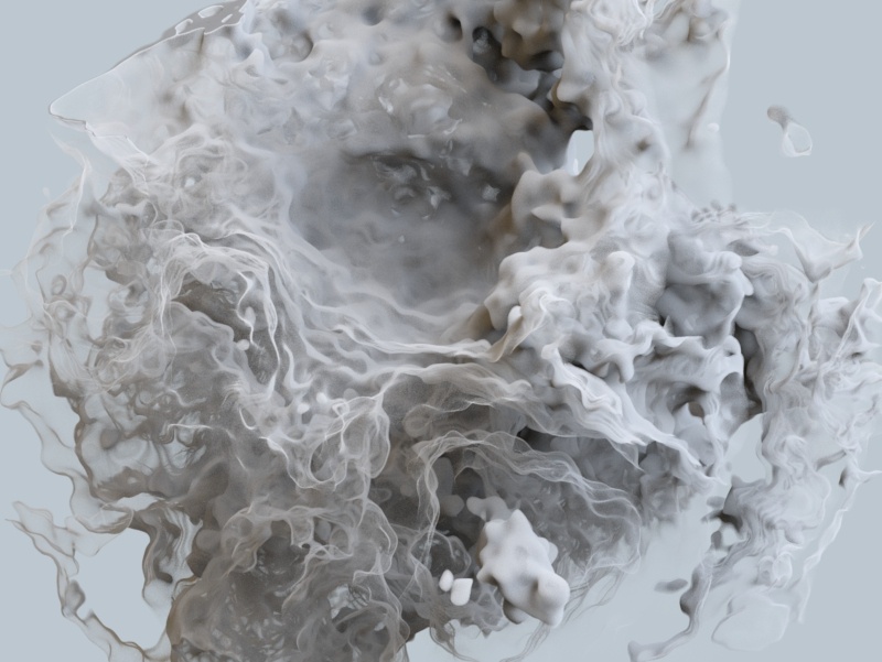

  • Create an Arnold Noise shader and connect it to the Displacement parameter of the Standard Volume shader.
That seems simple enough; however, there is a problem. The volume has been offset to the side and is showing displacement in only one direction.
Noise is only displacing in one direction

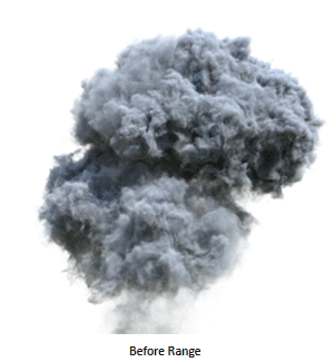

  • Change the Output Min to -1 in the Range shader. Now the Noise shader offsets in both directions, which is more correct.
Before and after using the Range shader

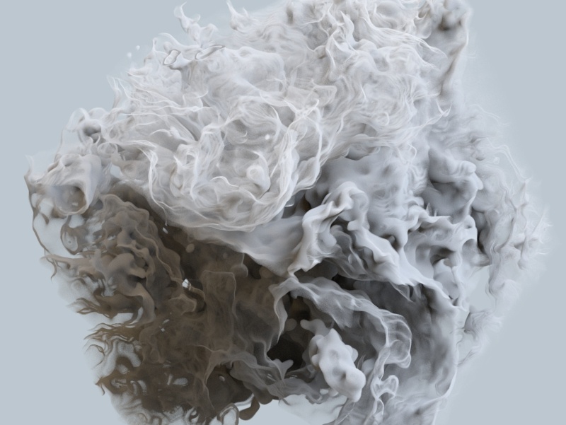

  • However, this is all a 2D effect. We need to create an offset in 3D space. We can do this using vector noise. To do this, go to the Noise shader and change the Mode parameter from Scalar to Vector and change the Range to (-1, -1, -1). Now the Noise shader offsets the displacement correctly in 3D space!
