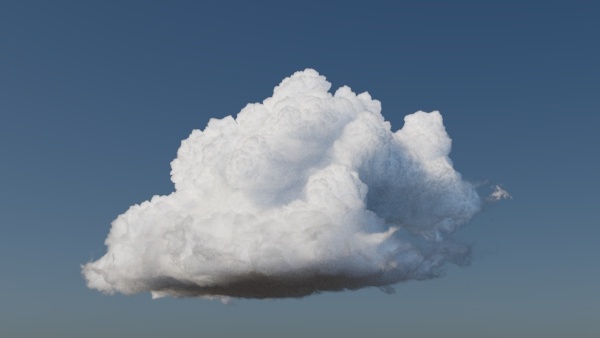

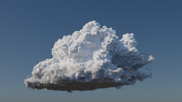

wdas_cloud_sixteenth.vdb. This is the lowest resolution version of the cloud data and so will be quicker to load initially (we will replace it at the end with the full resolution VDB file). - Increase the Step Scale to make the volume softer with less scattering. A step size of zero means that the voxel size will be used as the step size. A recommended value for Step Scale is between 10 and 20 for this dataset.
Step Scale: 1 vs 20.

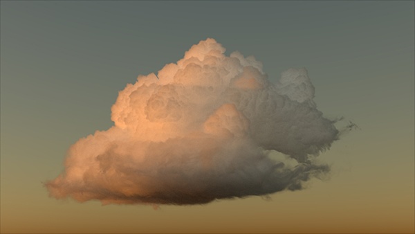

- Connect a Physical Sky to the color attribute of a Skydome Light. Adjust the Elevation and Azimuth of the Physical Sky to get an interesting lighting effect. Alternatively, you can just rotate the Skydome Light in the Y direction.
| Elevation: 45 (default). | Elevation: 10 (sunset). |

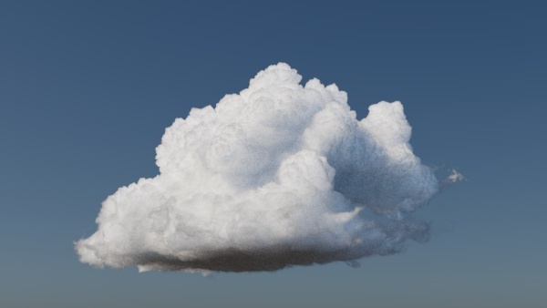

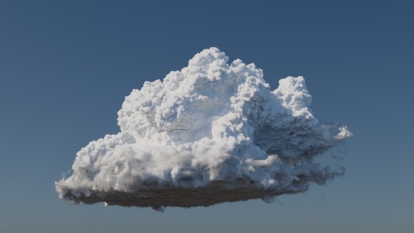

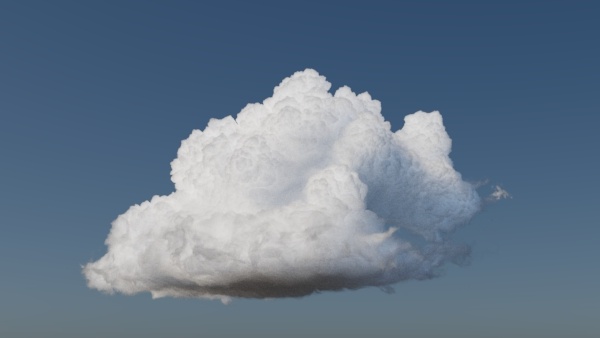

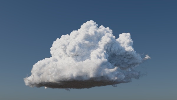

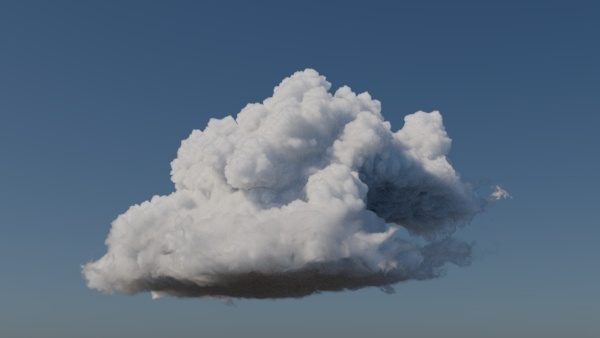

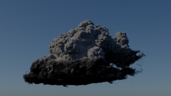

- Before you start rendering the volume, increase the Volume Ray Depth in the render settings to a high value like 50 (remember to increase the Total Ray Depth to 50). This is key to achieving the realistic cloud look as the light will bounce many times inside the volume, making it appear much brighter.
| 0 (default) | 10 |
| 25 | 50 |

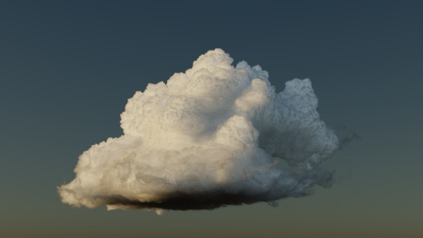

Once you are happy with how the cloud is looking, you are ready for final frame rendering.
- Replace the VDB file

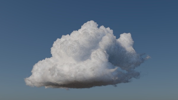

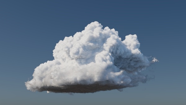

wdas_cloud_sixteenth.vdbwithwdas_cloud.vdb.Bear in mind that this is the full resolution VDB file and so will take longer to render.
'wdas_cloud_sixteenth.vdb' vs 'wdas_cloud.vdb'
- Once you are happy with the lighting (and shading) increase the number of Volume Samples for the Skydome Light to around 5 or 6.
- Increase Camera (AA) to around 5.

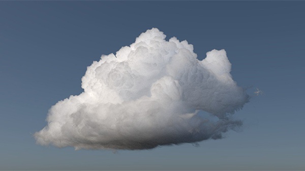

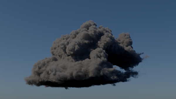

- Under Sampling in the render settings, increase Volume Indirect to around 3. This will help to remove noise from the indirectly lit areas of the volume.
Volume Indirect 2 vs 3.
- Finally, render the scene. That concludes this tutorial on how to render a VDB cloud data set.
