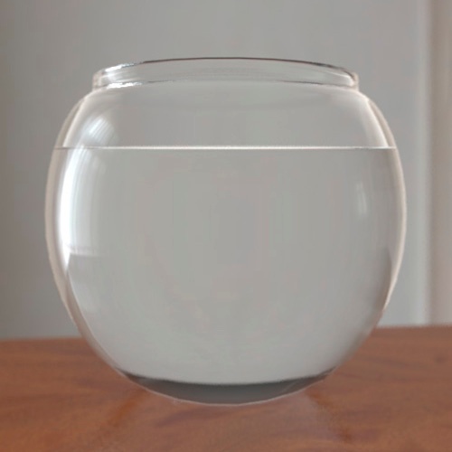

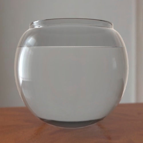

Transmission
Lowering the Transmission Weight value attenuates the amount of light that passes through the volume of the glass (distance-based coloring). By default, Transmission Color is white, which means no distance-based tint. Try lowering it from full white.
| Transmission Color: Gray | Transmission Color: White |

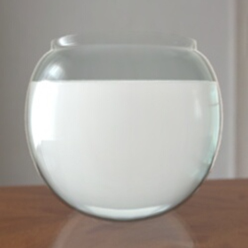

Standard Surface: Milky liquid
To create a milky liquid, it helps to add small amounts of sub-surface scattering. Additionally, to make the liquid appear more vibrant, you could experiment by adding a small amount of Emission Weight to it.
| SSS Weight: 0.1 | SSS Weight: 0.1. Emission 0.1 |
