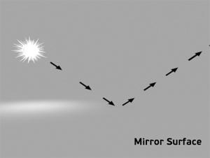

The light ray that hits a surface is called the Incident Ray, and the angle at which it hits is called the Angle of Incidence (as shown in the figure below). Light energy reflected back must be less than or equal to the light incoming to a surface (we cannot "add" light). On the surface, the ray is either reflected or refracted, and it can eventually be absorbed by either medium.
Angle of incidence, incident, and reflected rays

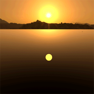

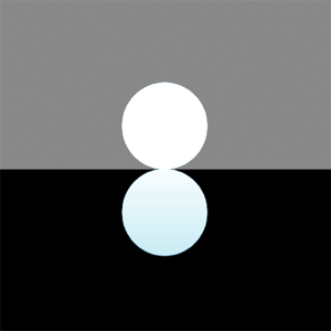

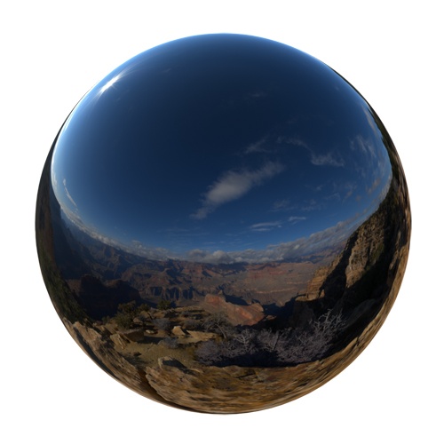

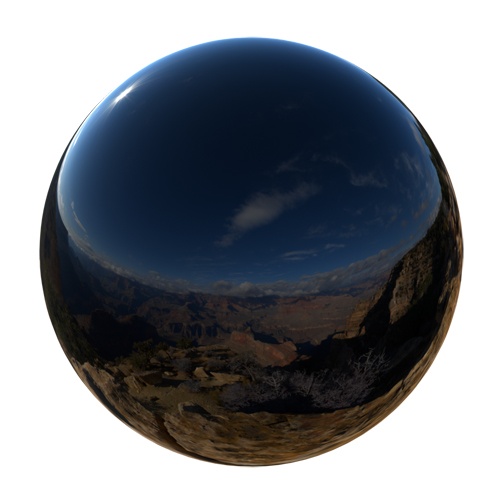

The Fresnel effect is named after the French physicist Augustin-Jean Fresnel, who first described it. This effect states that the strength of reflections on a surface is dependent on the viewing angle. The amount of reflection increases on surfaces viewed at a glancing angle.
When IOR is greater than 1 in the Standard Surface shader, the reflectance of the object will be view-dependent and vary according to Fresnel equations. The Standard Surface shader uses Schlick's approximation of the Fresnel equations and can be controlled by using the IOR of the material. At low values, the material behaves as a perfect dielectric, like plastic. With higher values, the material becomes a near-perfect conductor or metallic surface.

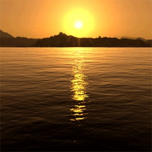

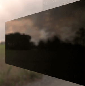

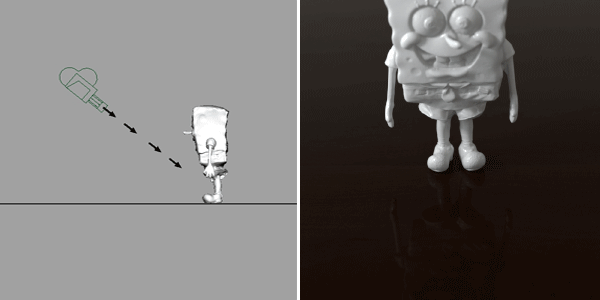

Fresnel is present in all materials in some form, being the most common examples glass and water. The example below shows the effect of Fresnel on a wooden table. Notice how the reflection on the table appears more reflective as the camera's viewing angle becomes shallower.
Variation of a Specular BRDF with respect to the view direction.
In the example below, the cube has a Standard Surface shader assigned using IOR. The Fresnel effect is visible. The specular glossy reflection appears brighter when the camera's viewing angle becomes shallower.

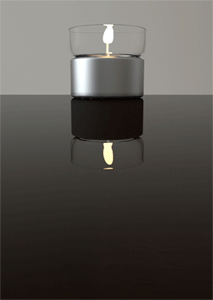

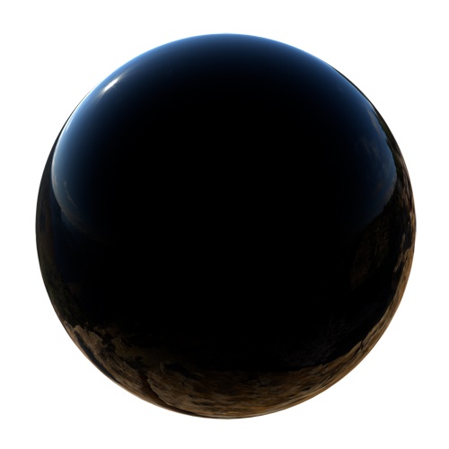

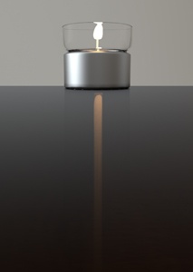

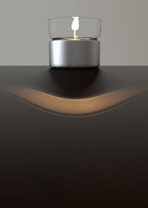

The images below show how surface roughness can affect specular reflections.
In the examples below, you can see that the specular reflection appears stretched when the surface becomes 'bumpy' or 'rougher'.

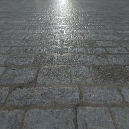

Anisotropy and Roughness

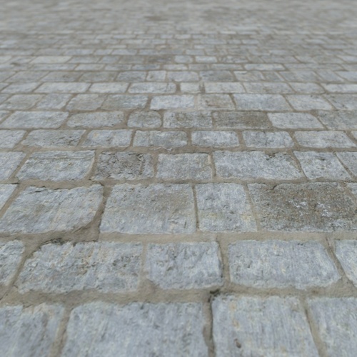

An example of an anisotropic material would be asphalt concrete. This effect is evident on the surface of a wet road. Notice that the wet surface appears diffusely darker and specularly brighter. When you are far from the surface, the stretched anisotropic reflection is more obvious on the ground. However, when you get closer, the stretched reflection becomes smaller due to the change in viewing angle. The anisotropic highlight size depends on the viewing angle.
Dry, diffuse road surface vs. wet anisotropic road surface

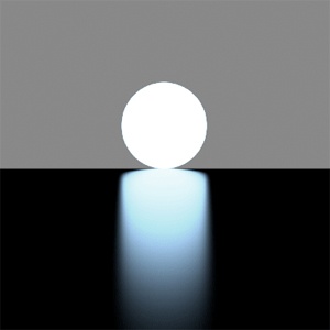

The example animations below show the effect of specular roughness when using anisotropy (0, 0.5, 1). The roughness values have been animated from 0 to 1 to demonstrate the effect.
Anisotropy Example

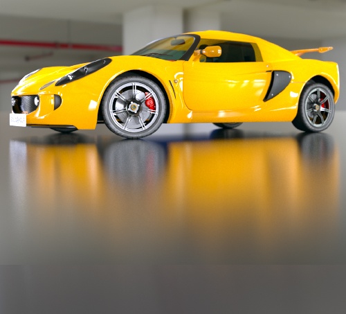

The images below show the difference between rendering with and without anisotropy on a floor surface. Both shaders have Roughness set to 0.2.
| Floor shader Anisotropy: 0 | Floor shader Anisotropy: 0.8 |
