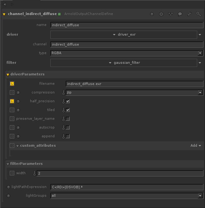

After the initial render settings, you should set up any AOVs that you want to be available in both stereoscopic eyes.  These are created with the ArnoldOutputChannelDefine node.  For example, adding both direct diffuse and indirect diffuse channels might have the following settings:
Note:
Note that the filename parameters, while set, don't actually have any effect; Katana will place those output files elsewhere.  The light path expressions (new to Arnold 5) control the light that is captured in the particular channel, and each channel will be available for any render output (and camera) later on.

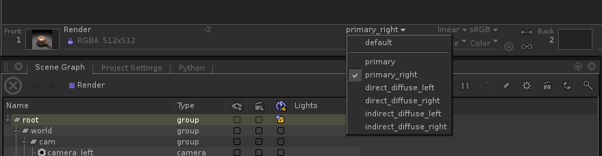

In order to get all of the left eye / right eye outputs into the monitor, they must be included in a RenderSettings node after all of the outputs have been defined.  The only changes that need to be made are to include all of the outputs that are now available:
The camera that was previously set in the cameraName parameter will be ignored because each output has its own camera.  The interactiveOutputs parameter allows you to control which outputs actually show up in the monitor; in this case, all AOVs for both eyes will be available, and can even be viewed as rendering progresses.  When rendering to disk, all outputs will be written regardless of the interactive output settings.
Results
An example scene is available here, producing the following outputs interactively. Arnold will automatically render each eye in turn, producing three AOVs per eye. The time spent on setup only happens once, resulting in overall faster renders. Switching between the same AOV but the left and right eyes will demonstrate the ocular distance between the eyes.
