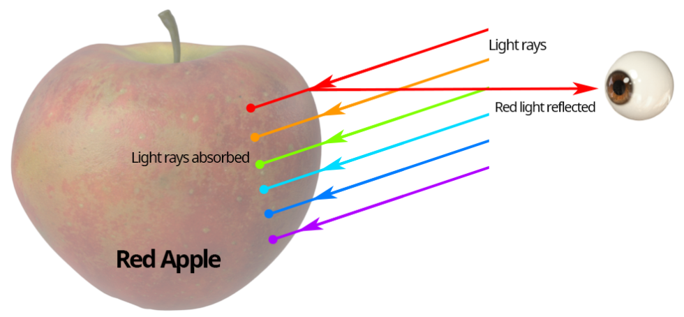

The diffuse interior also typically has the biggest influence on the overall color of the material. Each photon has an associated wavelength, and depending on the properties of the material, some photons with some wavelengths are more likely to be absorbed than others. This, in turn, means that photons with some wavelengths are more likely to leave the surface, which will give it a colored appearance.
The skin of a red apple mostly reflects red light. Only the red wavelengths are scattered back outside the apple skin, and the others are absorbed by it.

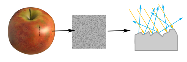

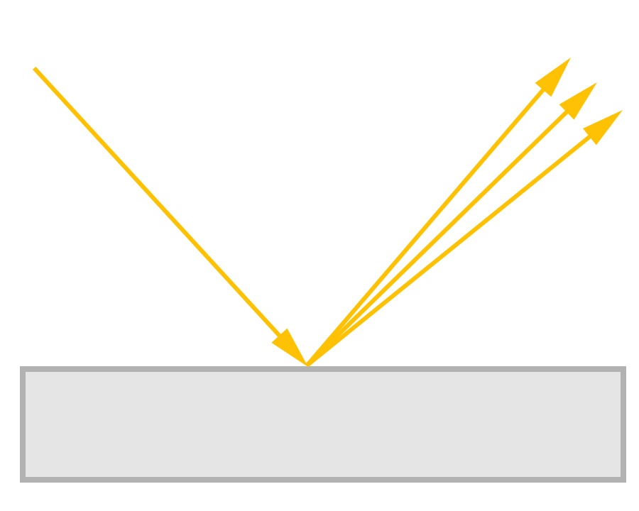

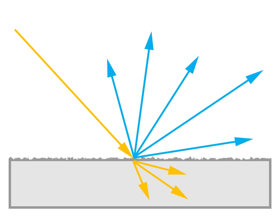

The specular layer is modelled using a microfacet distribution. We assume that the surface consists of microscopic faces oriented in random directions. A surface with low roughness, such as a mirror, will have little variation between the faces, resulting in sharp reflections. With high roughness, there will be a lot of variation, resulting in softer, glossier reflections.

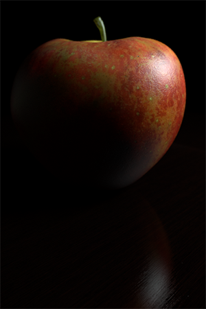

A strong Specular highlight is visible on the apple. Note the table's specular reflection which is broad and dull (high Specular Roughness value).
Rough reflections caused by scattered light rays
Glossy surface. Angle of incidence and reflection are equal. Diffuse surface. Ray direction varies randomly.

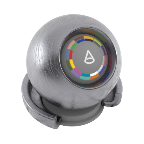

Roughness Map
To get variation in the highlights of the surface, a map should be connected to the Specular Roughness. This will influence not only the brightness of the highlight but also its size and the sharpness of the environmental reflection.
Low Specular Roughness High Specular Roughness
'Scratches' texture connected to Specular Roughness

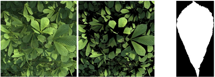

Opacity is best understood as a way to model surface geometry using textures. It does not affect how photons interact with the surface, but rather indicates where the surface's geometry is absent and the photons can pass straight through.
Ramp texture connected to the opacity

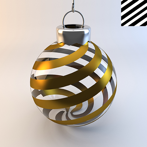

A typical use for opacity would be a sprite-type of effect, such as cutting out the shape of a leaf from a polygon card or making the tips of hair strands transparent. Be warned, however, that scenes containing many opacity sprites (for example, tree leaves) can slow down rendering considerably.
Leaf Opacity: Enabled (left). Leaf Opacity: Disabled (center). Alpha map connected to Opacity (right).

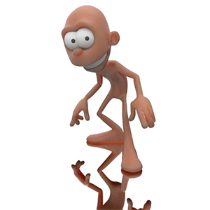

Transmittance is similar, but rather than the surface, it controls the density of the object's interior. Denser volumes will absorb more photons as they pass through the interior, making the object darker where it is thicker.
Transmittance Color: White Transmittance Color: Light Blue
Pepe model by Daniel M. Lara (Pepeland)
