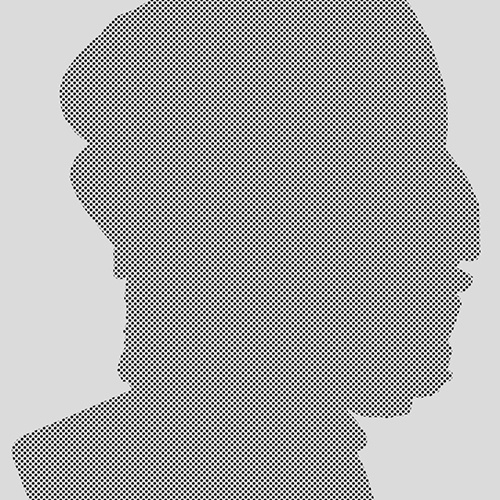

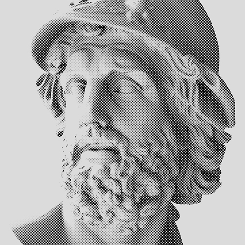

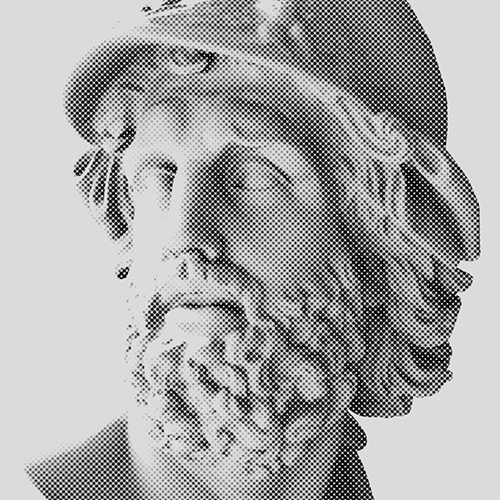

| Without ramp | Ramp -> Input Value of Halftone |
