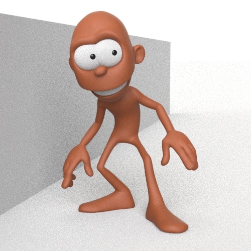

Renders computed with too few samples in each pixel can be noisy. Increasing the number of samples per pixel gives a less noisy image, which better represents the actual scene. The images below show a comparison when increasing the number of Camera (AA) samples in a scene. Not only does increasing Camera (AA) samples reduce aliasing noise, but it also adds more secondary ray samples, which also reduces noise in the lighting.
| 1 Camera (AA): 1x1=1 sample per pixel (image appears noisy) | 6 Camera (AA): 6x6=36 (noise is reduced) |

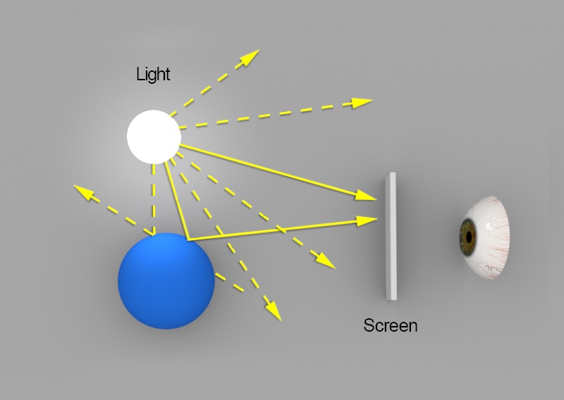

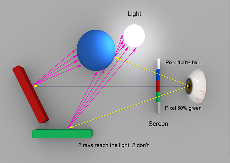

Direct lighting rays can be described as rays that deal with lights. These rays travel from a position in the scene toward the various light sources. These rays determine if a surface is in shadow, and if not, lighting information can be calculated.
Noise from lights can sometimes be difficult to diagnose, particularly if it is a light with a large area or size. In these cases, it can sometimes be mistaken for indirect diffuse noise. This highlights the necessity for testing different noise ray types. If the issue is shadow noise, then we can simply toggle ignore shadows in the Arnold render settings, and the noise will completely resolve. The images below show how a light is traced in Arnold.
| Some light rays hit an object while others do not | Light sampling in Arnold |

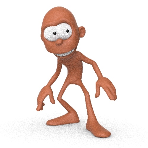

The same noise problems described earlier can occur with direct and indirect rays. Noise from direct light sources usually appears in specular highlights or in large, soft shadows from area lights. If this is the case, the number of light samples needs to be increased. The images below show the difference in the shadow noise when increasing the number of light samples from 1 to 3.
| 1 light sample. Very noisy. | 3 light samples. Noise is improved. |

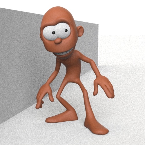

It can be useful to separate one source of noise from another when trying to evaluate noise in a scene. Disabling Diffuse rays (0) can help identify which type of noise is present. When attempting to optimize the number of indirect diffuse rays in a scene, rather than increasing the number of Diffuse rays (render time will double for each Diffuse sample), the source of the noise will need to be isolated first.
| Both light noise and Diffuse noise (difficult to tell which is which). | Diffuse set to 0 (disabled). Light noise is easier to identify. |

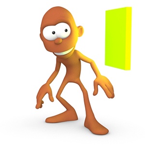

Indirect (diffuse) lighting from emissive green cube vs direct lighting only.

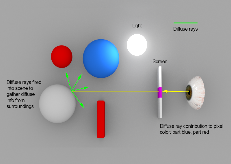

Indirect Diffuse rays are rays that interact with objects and their surface shaders. Therefore, rays travel in the scene in directions determined by the shader assigned to the object. Transmission rays travel through objects. When a ray hits a reflective object, such as a mirror, only one reflection ray is traced from that point in a direction determined by the incoming ray. In contrast, diffuse rays are sampled randomly over the hemisphere around the hit point.
Diagram showing how Diffuse rays are propagated in an Arnold render

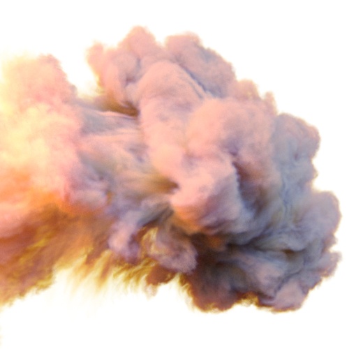

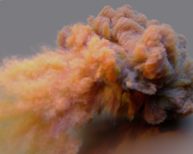

When sampling volumes, direct Camera (AA) rays sample the volume multiple times as they travel through it. Indirect rays (Volume Indirect) behave similarly, sent multiple times as the ray 'steps' (volume Step Size) through the volumetric object. Therefore, sampling a volume usually takes longer to calculate than sampling a surface.
Volume sampling. Direct lighting (green). Indirect lighting (blue).

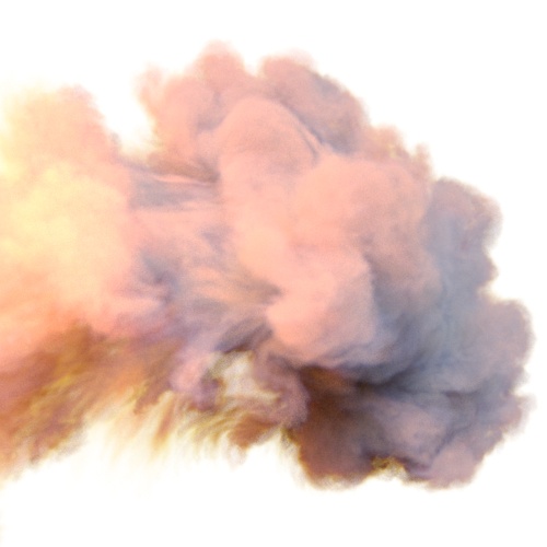

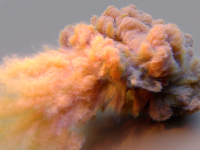

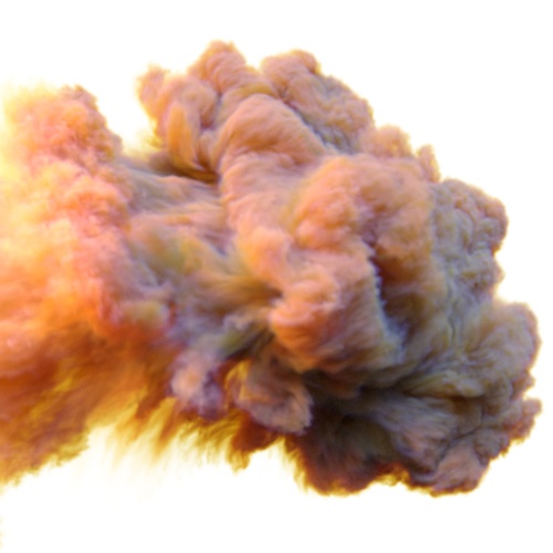

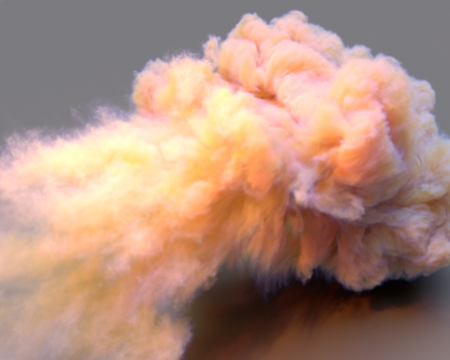

At each step the ray travels, it evaluates the shader and accumulates the density of the volume. When these density values become more erratic throughout the volume, nearby rays can calculate substantially different values, introducing noise into the render. In this case, it may be necessary to render using more light volume samples or to reduce the step size in the volume. Even with low sampling values, it can be expensive to render clean images with volumes.
| Light Volume Samples: 1 | Light Volume Samples: 6 |

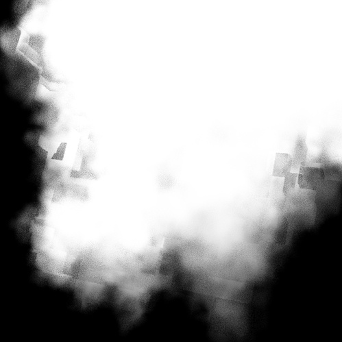

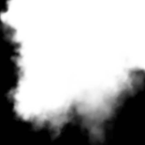

The Step Size of the ray marching process. Too low a sampling rate here will cause the volume rendering to miss small details in the volume, making them noisy, making them thinner than they should be, or making a bad estimate of the exact position of the 'surface' of a 'solid' volume like a pyroclastic cloud. A bad Step Size has a snowball effect that can make the rest of the sampling process noisier. This is pretty easy to test by looking at the alpha channel, or by adding some emission to the volume and turning off all lighting. If the emission/alpha channel is noisy at the desired Camera (AA) setting, then the Step Size is probably too large.
| Step Size correct | Artifacts appear in the alpha when the Step Size is too large |
Step Size is actually in object-space and not in world-space. This is so that the sampling quality remains the same upon scaling of the volume's transformation. However, unreasonably large step sizes should be avoided. Otherwise, the volume will appear thinned and washed out. In the example images below, the volume has been scaled up to 100 units to exaggerate this effect (1/25/50 are relative to the size of this volume).
