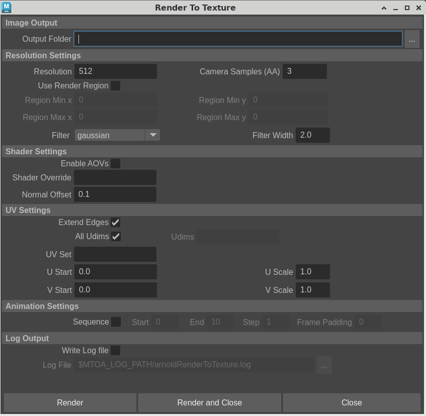

- Render To Texture now supports USD stage selection - Users can now use Render To Texture on nodes inside the Maya USD stage. The UI has been improved to make it easier to use (MTOA-2180)
| New Render To Texture UI |

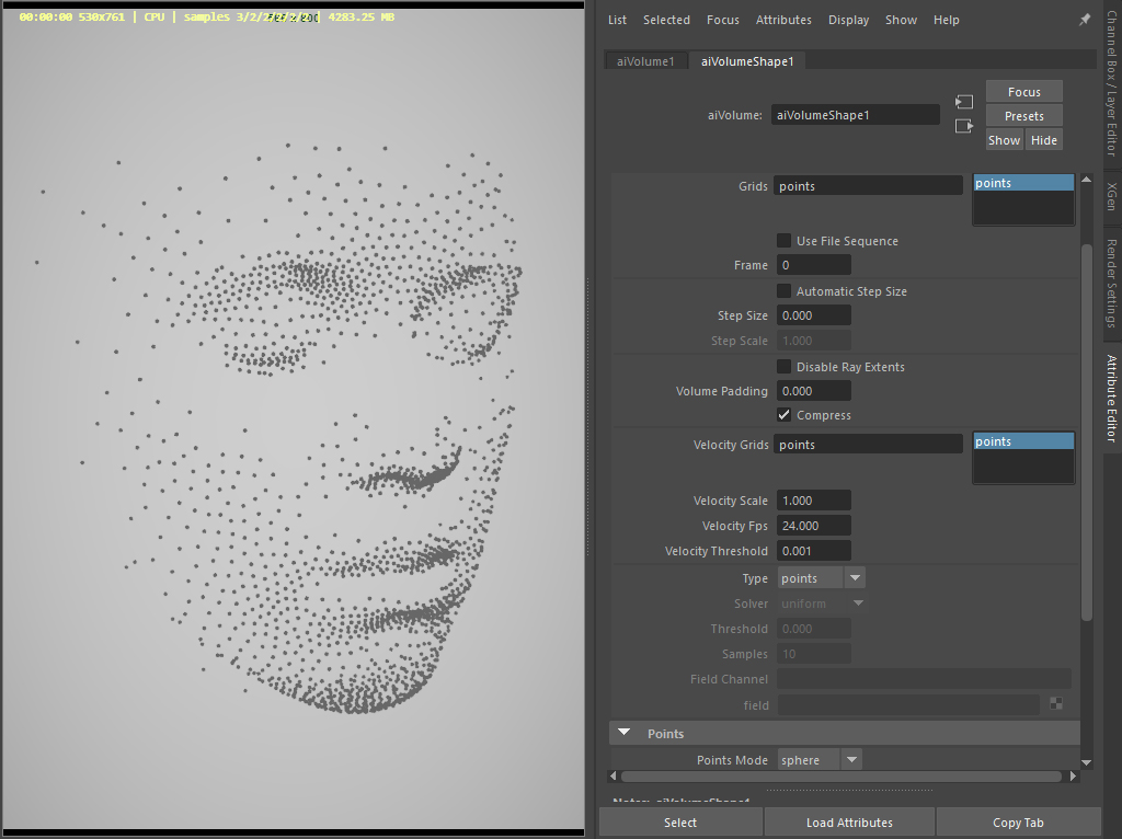

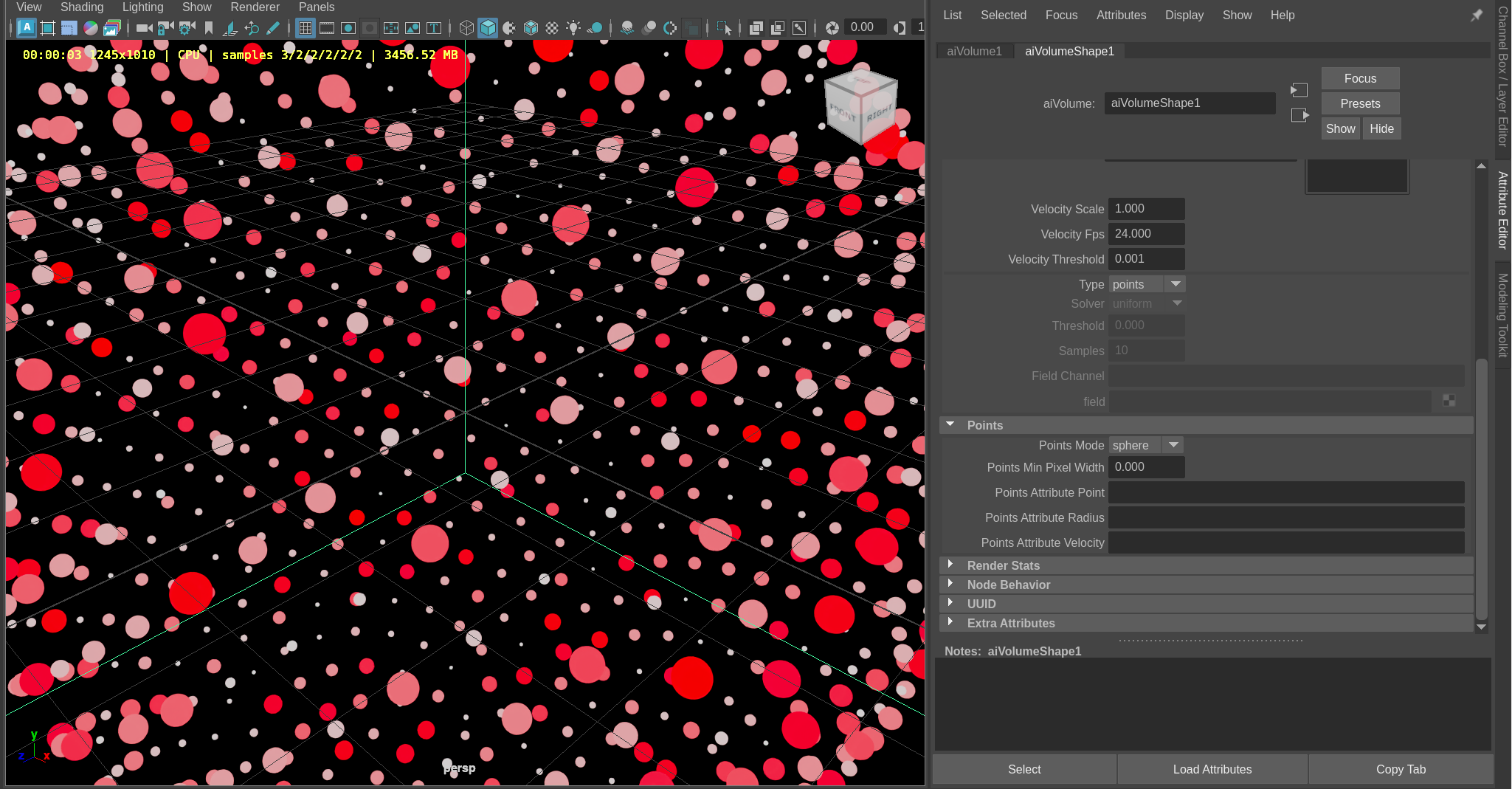

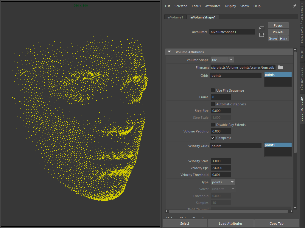

- OpenVDB points support in the aiVolume node - You can now load VDB files that contain points data and render them as Arnold points primitives (MTOA-2234)
| VBD points in aiVolume |
Volume points displayed and rendered in the viewport

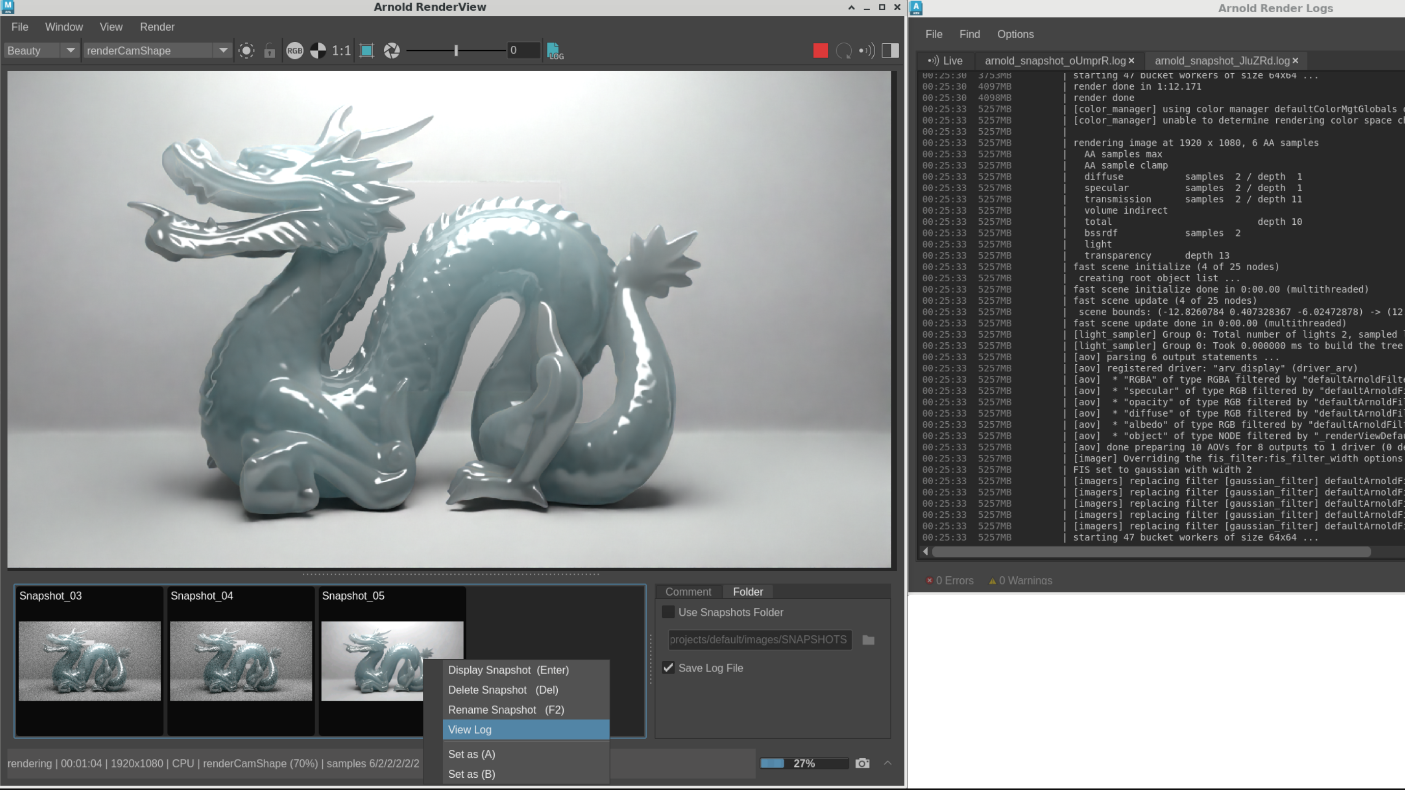

- Render logs can now be saved with snapshots in Arnold Render View - When saving snapshots you can now save the current render log and view them in the Arnold Render Logs window (ARNOLD-12266)
| Save logs with snapshots |

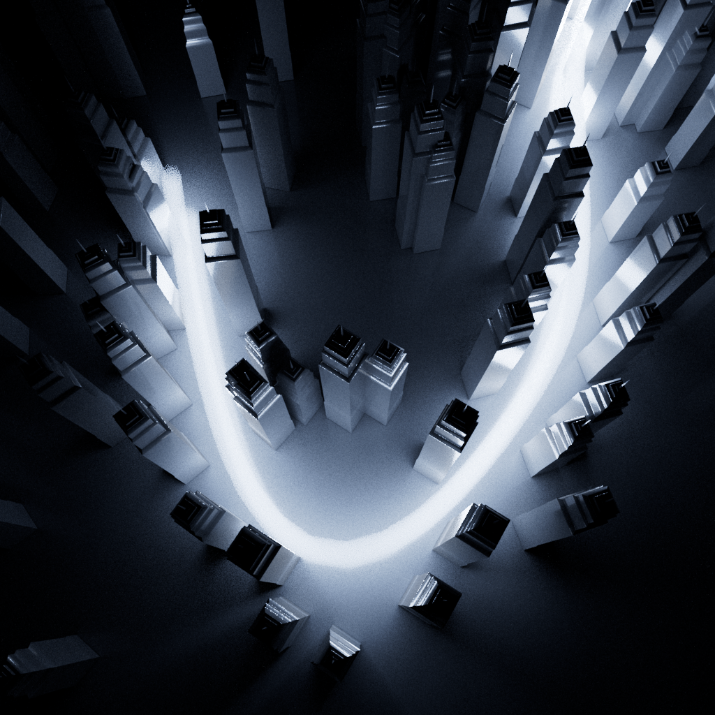

Improved Global Light Sampling: Rendering photometric (IES) lights and mesh lights using Global Light Sampling is now higher quality, using the same render settings and taking the same render times. (ARNOLD-13692, ARNOLD-15859)
Before-and-after comparison: improved renders of various IES profiles (with equal render times and render settings)
Before-and-after comparison: improved renders of a motion-blurred mesh light (with equal render times and render settings)
