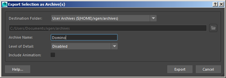

- With the domino model selected go to *Generate > Export Selection as Archive(s)...*
- Rename the Archive Name to domino and choose where you want to save the archive file.

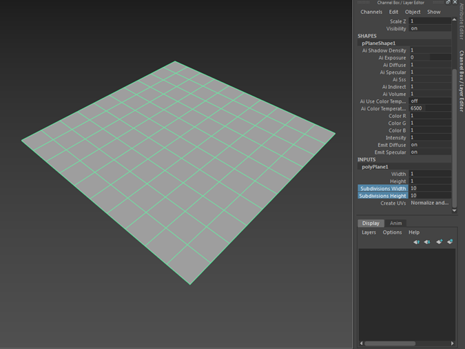

- We now need a surface to apply our XGen domino archive. Create a polygon plane and increase its Subdivisions Width and Subdivisions Height to 10. We will use this plane to assign the XGen description.

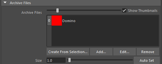

Go to the Primitives tab and under Archive Files, select Add and go to the location where you saved the domino archive previously. Click Yes to import the Materials that were exported with the saved domino archive file.

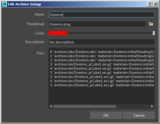

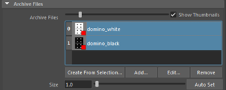

- It is possible to change the color of the icon for each domino and even add an image icon that represents each archive. To do this, right click on the red square for one of the archive files and choose Edit.
- Click on the Thumbnail folder icon and choose a bitmap that represents each domino. In the examples below, you can see that we have screen grabbed the Maya viewport for each domino and saved those images to files. We can also change the color of the icon and increase its size by adjusting the slider above:

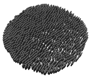

You should end up with something like this (Preview Percent 100):

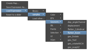

Twist Expression
- Under Primitive Attributes, click on the downward pointing arrow
to the right of the Twist slider control.
- Select the following from the menu:
| Load Expression>samples>Geometry>flatten_Room |
You should see Width and Depth attributes appear under Twist :

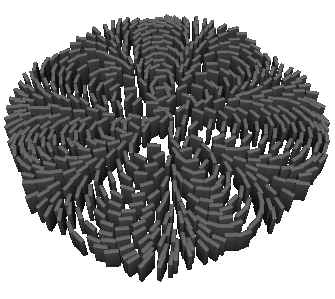

Twist Width

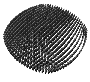

You can see the effect that increasing the Twist Width slider in the animations below (Twist Width values animated from 1 to 1000).
Randomly across the surface (left). In uniform rows and columns (right).
Around N
If you are noticing intersections between the dominoes, you could try reducing the Density or Size of the dominoes. Alternatively, you could try adjusting the Around N value. This attribute rotates the archive around the surface normal vector (this vector is not affected by Bump, Tilt U, Tilt V, etc.).
'Around N' values keyframed between -180 and 180
The images below show varying Twist Width values with primitives generated both Randomly across the surface and In uniform rows and columns:
