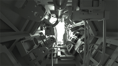

Satellite interior scene rendered with an Ai Area light

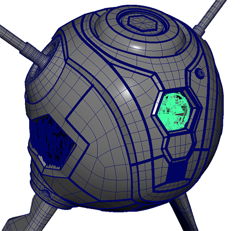

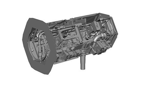

  • Open the satellite scene file. You will see that it comprises an outer body, door, and interior (selected below).
  • Hide the rest of the objects so that you are left with just the satelliteInterior group.
'satelliteInterior' group

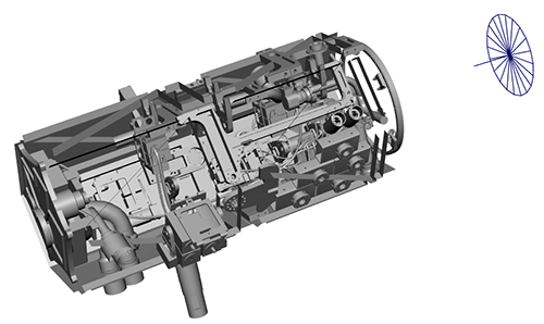

Disk Light
  • Create an Ai Area light. Change the light_shape to disk and position it so that it is pointing through the doorway as in the image below.
  • Increase the exposure to around 18.
  • Render the scene with light samples set to 1 and then with 3. You should notice that some of the noise is improved. However, in general, it is difficult to tell if the noise is coming from the light or from elsewhere.
light.samples: 1 light.samples: 3

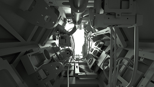

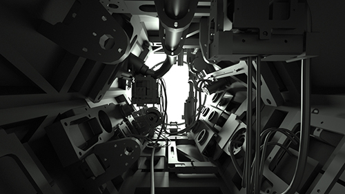

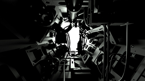

This tutorial uses an Ai Area light with its light_shape set to disk. However, when rendering interiors with square windows, you would be better off using a quad_light. The quad_light also has a spread attribute that allows for focusing illumination along the light direction. This can be useful when rendering interior scenes. The images below show the difference in rendering this scene with different spread values.
spread: 1 spread: 0.5 spread: 0.25
The animation below shows the effect on the interior lighting when decreasing the lights spread attribute.
quad_light.spread: 1 to 0.25

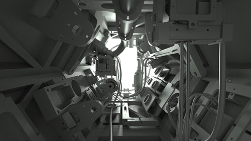

Setting Sampling Values, Ray Depths, and Clamping
AOVs

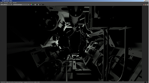

Even though we have increased the number of Light sample settings, we still have noise. We can try and resolve this by adjusting the Sampling values. Careful consideration must be taken when increasing these values as it can have a big effect on render times. A quick and easy way to identify where the noise is coming from and therefore which samples to increase is by rendering out AOVs.
Note:
More information about sampling and removing noise can be found here.

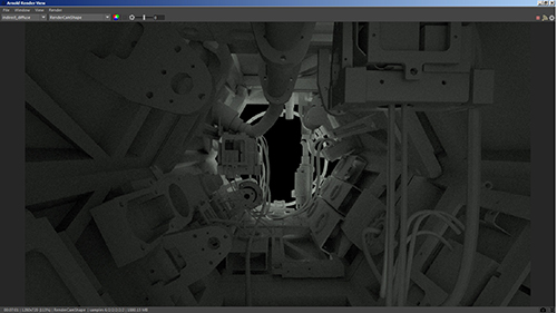

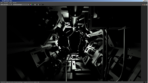

  • Render the scene with the Arnold Renderview window. You should see the Beauty render being rendered by default. You can change which AOV that you wish to see by clicking on the drop down menu or by going to View> AOVs.

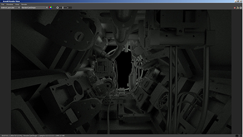

On closer inspection of the AOVs, we can isolate and identify more clearly where the noise is coming from in the scene. There is little noise visible in the direct_diffuse and direct_specular AOVs because we have already increased the number of direct light.samples. However, there is much more noise visible in the indirect_diffuse and indirect_specular AOVs. Therefore, we will need to increase the diffuse_samples and specular_samples respectively.
The images below show the AOVs visible in the Arnold Renderview window.
direct_diffuse direct_specular
indirect_diffuse indirect_specular

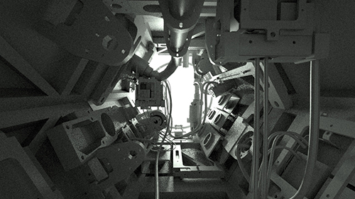

Camera (AA) Samples
We can try increasing the number of camera (AA) samples to help resolve some of the noise in the scene. However, there is still noise visible in the indirect diffuse and specular areas.
3 6
Diffuse Samples
The images below show the difference when increasing the number of diffuse Samples.
2 4

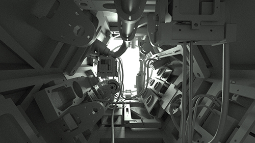

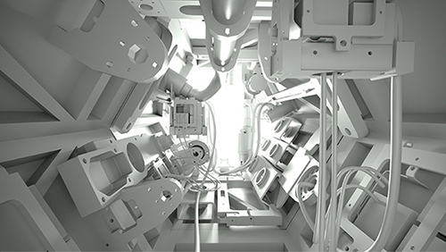

Diffuse Ray Depth
This defines the maximum ray diffuse depth bounces. Zero diffuse_ray_depth is equal to disabling diffuse illumination. Increasing the depth will add more bounced light to the scene, which can be especially noticeable in interiors. You may notice subtle differences when increasing the diffuse bounces incrementally in the images below.
0 (direct light only) 1
2 3

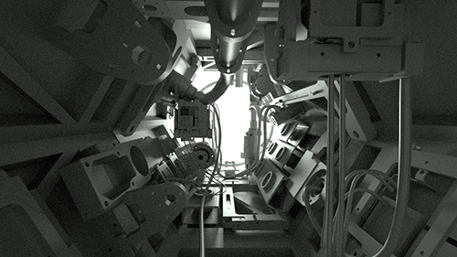

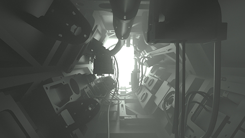

Adding Atmosphere Volume
To add some atmosphere to the scene, you could try adding some atmosphere_volume to the scene.
  • Go to the Environment tab of the Render Settings. Connect an atmosphere_volume to the Atmosphere attribute.
  • You will not see any result if you render the scene. That is because the atmosphere_volume.density is 0 by default. Increase it to 1 and IPR render the scene.
Adding atmosphere_volume has introduced some fireflies into the render. We can try to reduce them by increasing the number of atmosphere_volume.samples.
Note:
More information on how to deal with fireflies can be found here.
However, even after increasing the number of atmosphere_volume.samples, there remain some fireflies.
5 20
